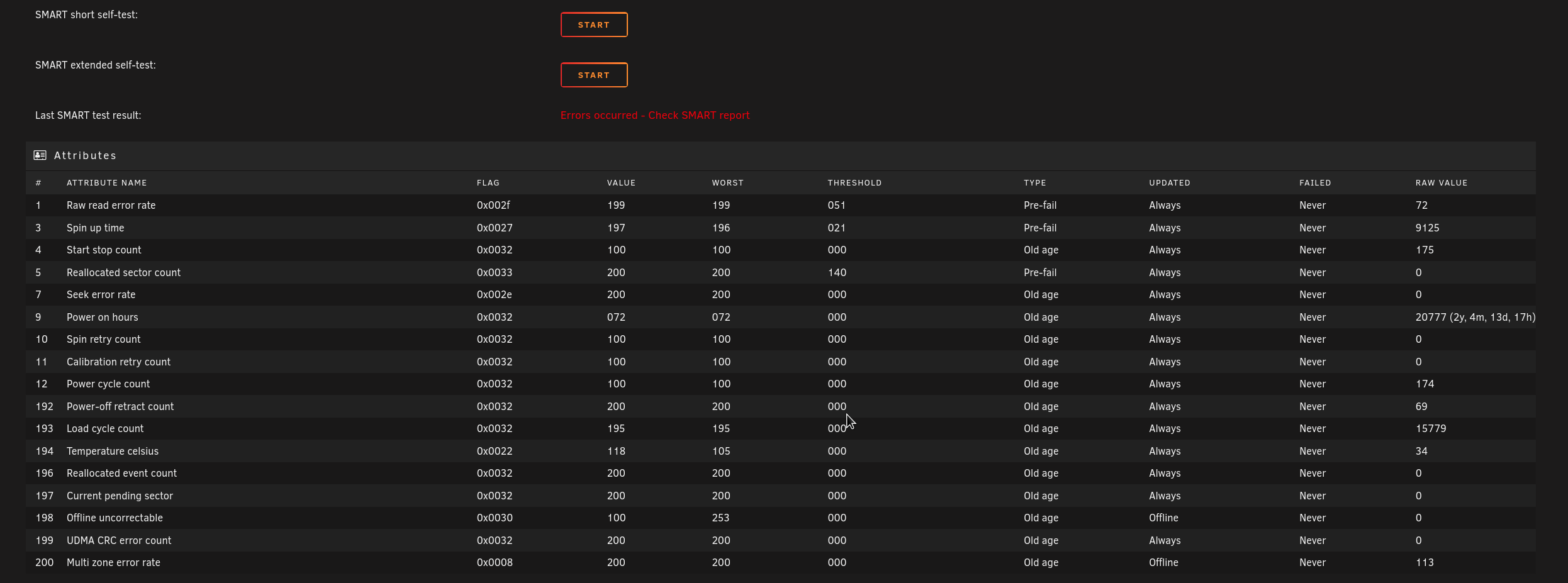

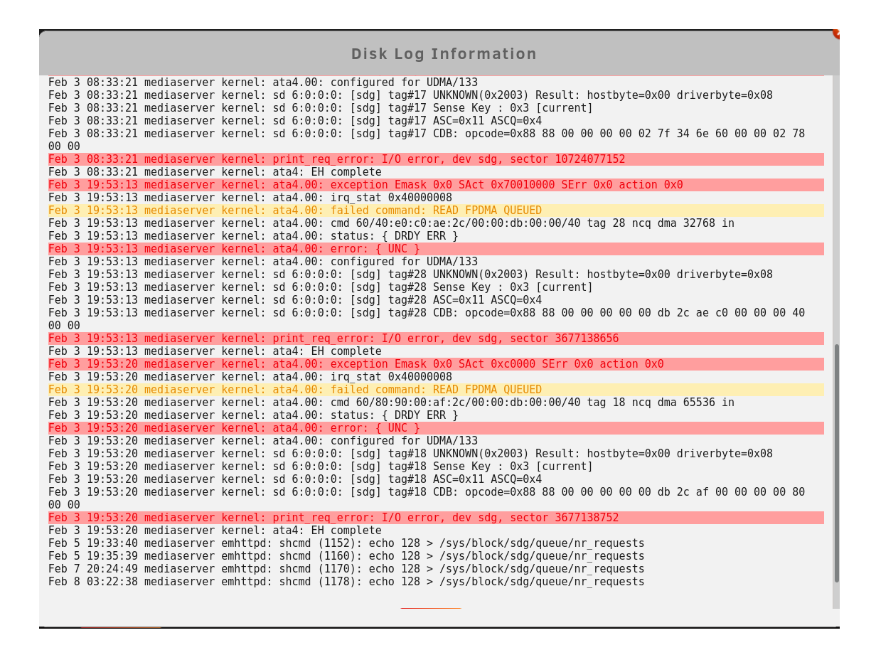

Disk 1 kicked up some errors,
whats best approach to resolve this, or is the disk dying?
It would be best to post the full diags, but it does look like a disk issue, run an extended SMART test.

It passed the last extended test, but if failed one a few hours before:
Num  Test_Description    Status                  Remaining  LifeTime(hours)  LBA_of_first_error
# 1  Extended offline    Completed without error       00%     20800         -
# 2  Extended offline    Completed: read failure       40%     20745         7337814160
This confirms it was a disk problem, it is fine for now but you'll want to keep an eye on it, it will likely fail again soon.
