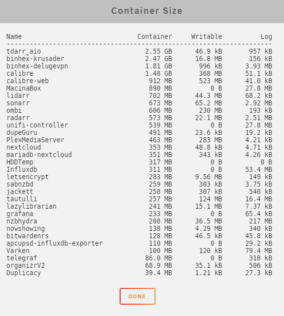

I did as you suggested above.  Things have been warning/error-free for a couple of weeks now, but last night they started popping up.  Think I should increase the size of docker.img?  Screenshot of current state of docker containers below and updated diag. attached.

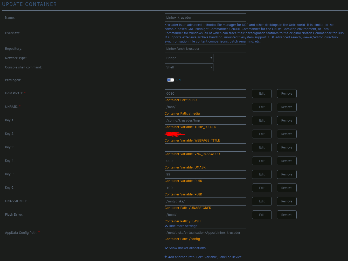

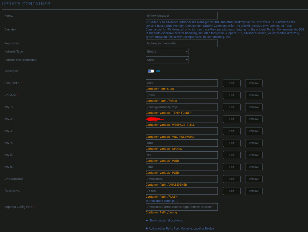

Circling back to this.  I suspect my krusader docker is the culprit, although I'm not sure what I may have set up incorrectly.  I usually don't leave it running unless I need it, but the few times I've had docker image size warning (I think) have come when it's been left on.  Every time I start the docker I have to go through set up because it tells me I can't save bookmarks to the hom/nobody profile.  I've always ignored that, but think it may have something to do with things.  If it can't write to that location I suppose it's possible it's creating a temp folder somewhere in my docker image?  I've pasted my config below in case anyone can spot something I've done wrong.  I may post over on the binhex krusader help thread as well.

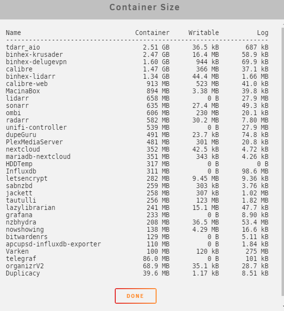

Says my krusader size is 1.7G. Is this normal?
Yes, it's a hefty container.
Do be aware that it's really easy to put stuff inside krusader's file system and balloon that number. Pay attention to the delete / recycle function of krusader.
