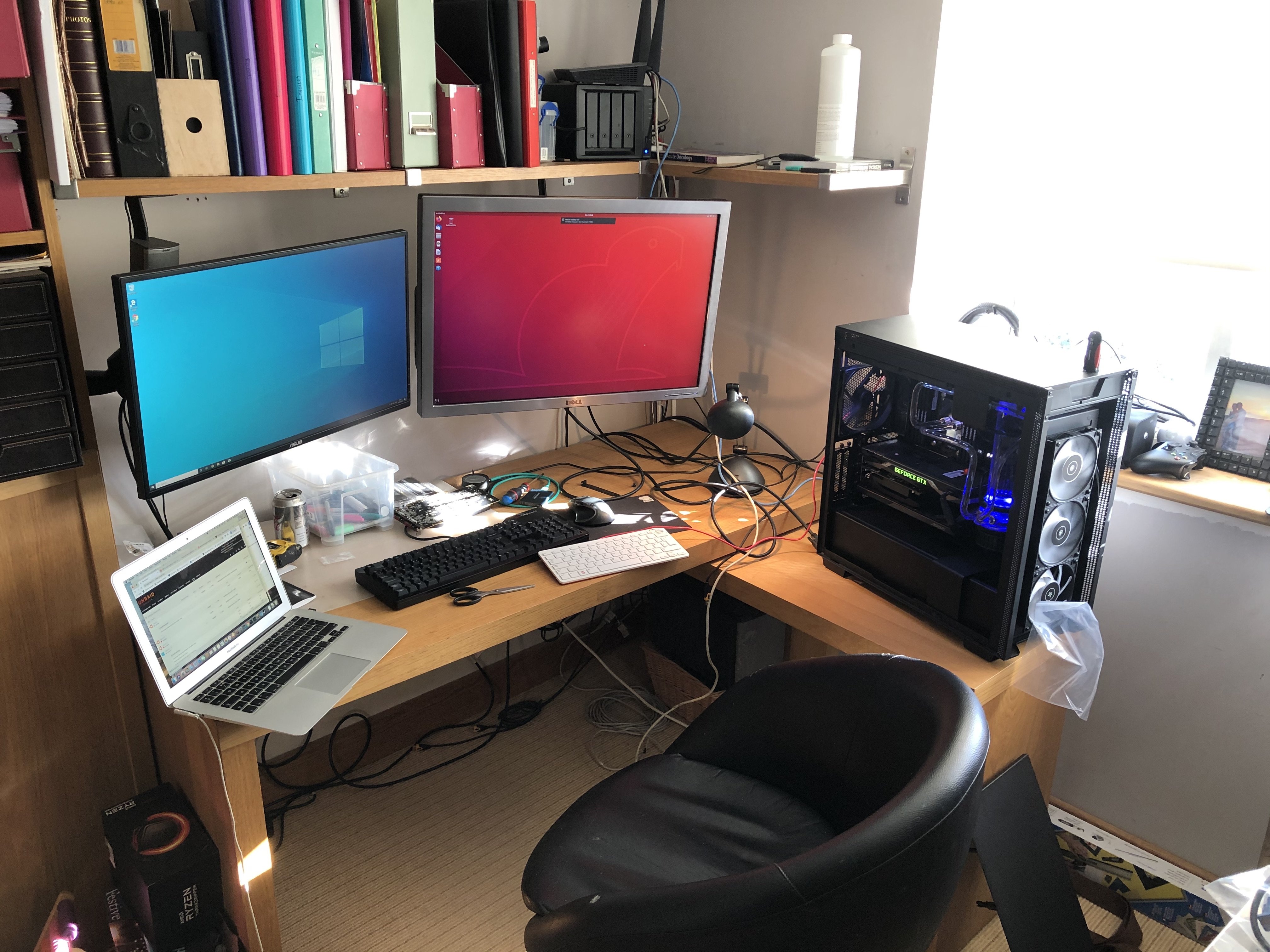

Holy cow... it works!! Stopping unraid from using my AMD GPU with video=efifb:off was the key to success..
Behold the glory! Now I just need to figure out the best way to share a keyboard/mouse

Very cool!
If you need a keyboard and mouse for each you will need two of each, and either pass through usb controllers to each VM, or just the usb devices. Best way to go would be passing through a usb controller to each VM, as that gives you the ability to hot swap USB devices.
