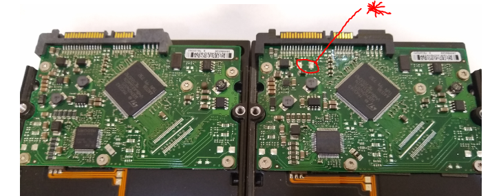

Without second guessing the cause too much, the drive bays are usually simple affairs which just have PCB traces for SATA and power so little to fail catastrophically. If it's the white molex type of power connector, is it possible that a molex was reversed so the 5V and 12V supply on the edges of the plug were inverted? I had it happen to me once when I used an incorrectly wired molex cable. It was a good few years ago and it was a 500GB drive. It's still in the cupboard next to me so I grabbed to photo below from it and it's twin.
I assume you tested the drives for spin up on an independent cable?
In my case the fusible component (red asterisk) had gone dead short protecting the drive. I removed it and the drive then spun up and still works fine though no longer has protection. I since use it for testing etc. however I've never relied on it again. My data was ok.
It's likely the drives have some sort of polarity, over voltage or similar protection so may be salvageable with some minor surgery unless the PCB is a smoking ruin. If you check for a dead short between the 5V and GND and 12V and GND with a multimeter (sata to molex connector makes this simple) you'd be able to check for this type of failure and won't do any additional damage. It's also possible that a fusible link went open circuit, again to protect the drive.
On more modern drives, the components are usually hidden under the PCB so you have to remove a few PCB screws to get access.

Decto, your advice gives me some hope however as you noted they all have the PCB board covering the stuff I see on the screenshot, and I am definitely not brave enough to open it up and mess with it :(
