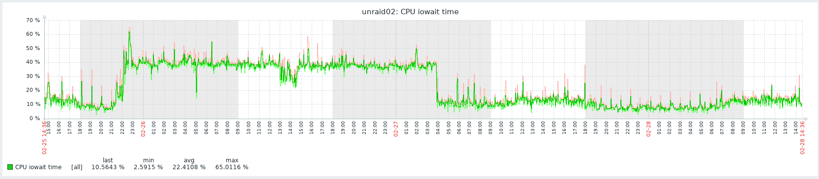

Then, after some other have-to-do-things, I finally got around to convert the old Zabbix database. Thank you very much for quickly providing that @ich777.
I can see quite some high IO wait that could explain the sluggishness. For the last few days it usually keeps around 10% with a 6 hour plateau around 40% one night. This feels a bit too high...
