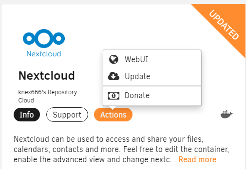

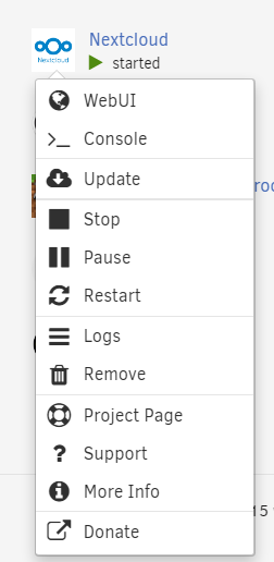

I'm having some issues with my install. For some reason I have lost the ability to edit the container. Second, I'm getting the notification of an update, but each time I get this error "Configuration not found. Was this container created using this plugin". I am also unable to uninstall the container, no option to. I've attached screenshots. Thanks for your time.
This would happen if the template for the app was somehow deleted from your USB drive (should be in config/plugins/dockerMan/templates-user). Have you had USB issues or can copy it back from a backup?
This is what is in that folder for nextcloud. I do not have current backup.
