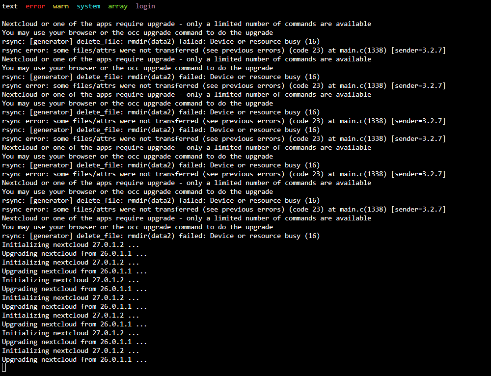

Hello,
I have this issue with my docker image. It tries to update itself but seemingly fails.
I would appreciate any suggestion how to solve this.

Got this figured out however I dont know what relation the problem has to the solution. I have mounted multiple folders into the docker other than the default data folder, I made data2, data3 and so on then I have these mapped inside nextcloud.
For whatrever reason this broke nextcloud docker, I removed the path mapping, rerun the docker template and the system started. Then I added my mappings again and there I have it, running again and all my folders are mapped.
