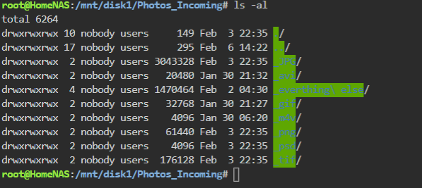

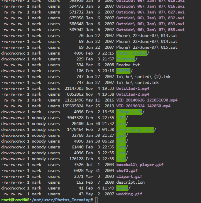

So far I have been treating subfolders of subfolders of /mnt as interchangeable.  But from the terminal, if I go to what I thought was the same directory mapped differently, one folder contains a lot more.  Can someone explain how/why the directories are set up this way?
https://wiki.unraid.net/UnRAID_Manual_6#User_Shares
Your first shot is only /mnt/disk1, the second is /mnt/user, which shows all the disks.
Same files, different view. Don't copy or move files between the two different folder structures without understanding exactly what is going on behind the scenes. You WILL erase your data if you do it wrong.
