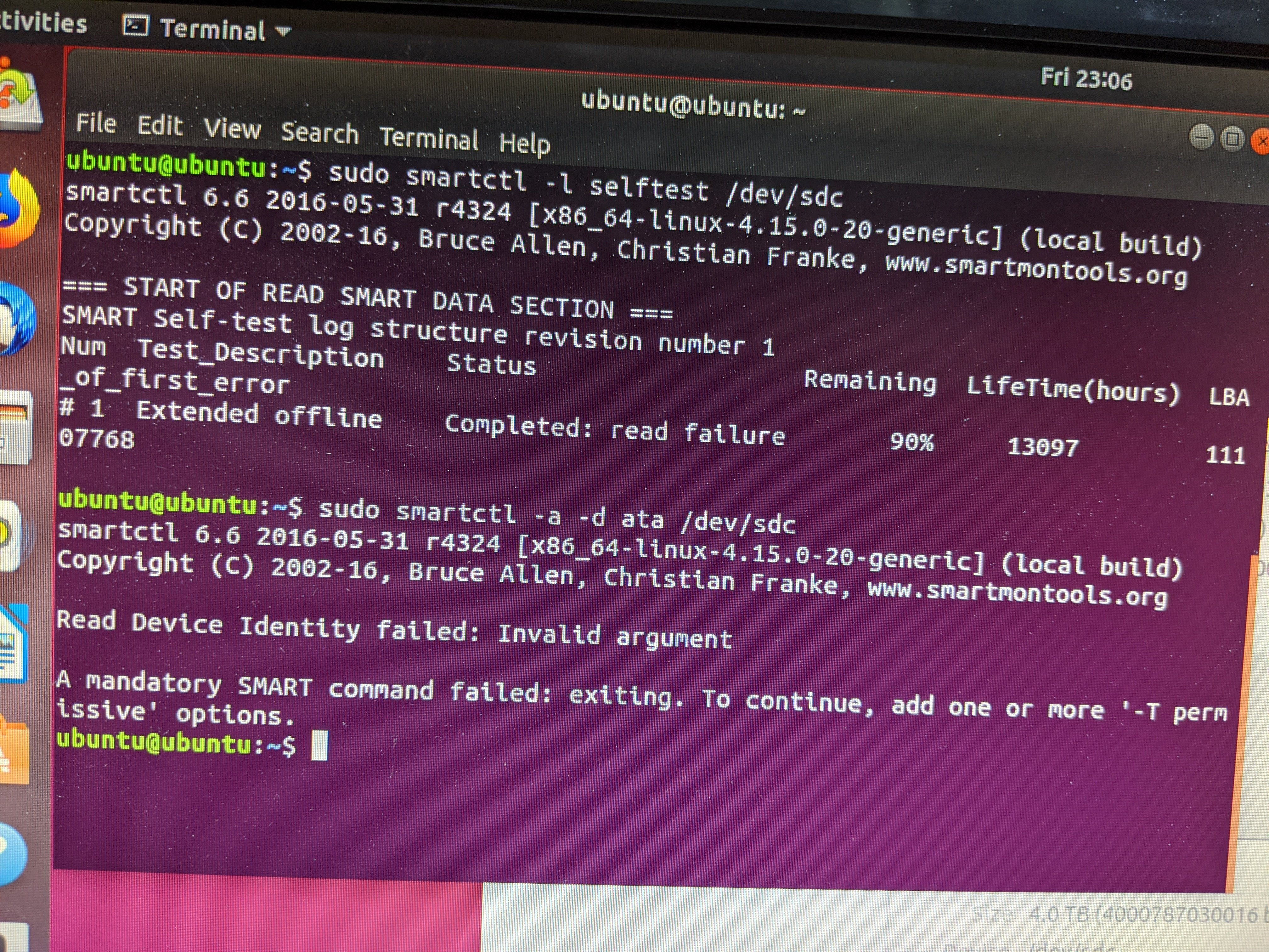

I don't know if it was me being exhausted last night, the drink I had or if things are just different today but the result changed. I've revisited the situation again today and found the following:
I'm working on just the 4TB to start with:
4TB drive (showing with a red cross next to it in unRAID), I've put this into a USB caddy and its showing up on Ubuntu on the "disks" utility.
I've installed SmartMonTools for Ubuntu and skipped the Postfix settings as I thought I'd apt installed the wrong tool as postfix is an email thing.
I've since ran
sudo smartctl - i /dev/sdc
Which provided me with info about my WD drive and it supporting SMART (and it being enabled)
sudo smartctl -c /dev/sdc
Which showed me that the extended test would take 506min (which is fine with me)
sudo smartctl -t long /dev/sdc
Which then started the test and told me to check back in 5hrs 26 minutes.
I'll run the following commands to gather further information after this period has passed
sudo smartctl -l selftest /dev/sdc
sudo smartctl -a -d ata /dev/sdc
Is everything I'm doing correct so far?

Report is attached from SMART
Tried my 2TB drive this morning, it doesn't even show up in the Disk utility on Ubuntu. Think this drive is beyond broke.
