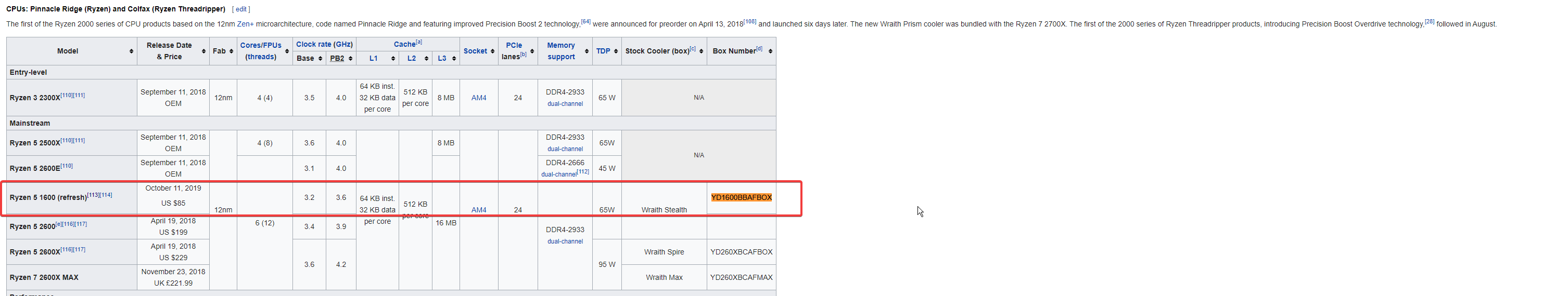

mmm ok i really thought this was a second gen CPU
according to https://en.wikipedia.org/wiki/Ryzen it has zen+ architecture which i assumed was 2nd genimage.thumb.png.b2d8d863b78174a234514dd8d792234f.png
but in the name it does say: Ryzen 5 1xxx (Pinnacle Ridge)
very confusing to me 🙂
It's a refresh of 1st gen Ryzen, not 2nd gen CPU, first model number denotes the generation, they are on gen 3 now, models 3xxx.
