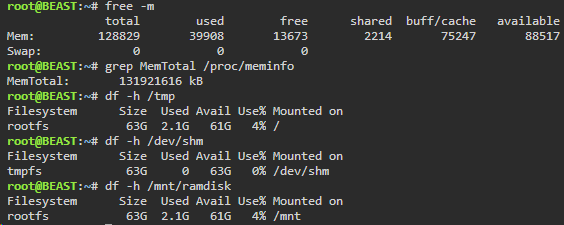

Seeing less than half RAM for /tmp and ramdisk?
I have 128GB of RAM in my system (AMD EPYC) and Unraid clearly reads all 128GB but yet only shows half that is available in /tmp or a /ramdisk I've created.  I was aware of /dev/shm only allocating half ram but I was under the impression that /tmp would be able to see and use all available ram, and same for a user created ramdisk.  Am I missing something?
EDIT:  It looks like Unraid is caching more than half my RAM but not making that RAM available?

Bumping out of curiosity, I have 256GB of RAM and /tmp only shows me 128GB
/tmp is mounted to use 50% of the memory available maximum.
Cached memory should be always as much as possible.  Cache is always returned to the system when a process needs it, and unused RAM is wasted RAM.  https://www.linuxatemyram.com/
So if I start writing more than 63GB to my ramdisk more ram ram should be allocated on the fly to accommodate?
I ask because I'm not seeing that happen.  I use my ramdisk for incomplete usenet downloads and when that 63GB is filled I cant write anymore.  Meanwhile I have another 40+GB of free RAM apparently doing nothing.
No. Your ramdisk is not resized on the fly. Memory is used as I/O buffer and released to other processes as needed, but this has nothing to do with your ramdisk allocation.

And /tmp is the same scenario?
If the memory is required, then another process can use it.
IE: On a 16Gig system, you will see that rootfs (where /tmp is) is sized at ~ 7.8G.  But you can run (quite easily) 3 VMs at 4Gig a piece without running out of memory.  The memory used (ie: dashboard) will reflect this.

It won't ever use more than 50% of your RAM.  It will however only use as much as necessary up to 50%
Then yes, its of no use to me.  That's disappointing that there is no ram directory that I can use more than 50% of my ram with.
