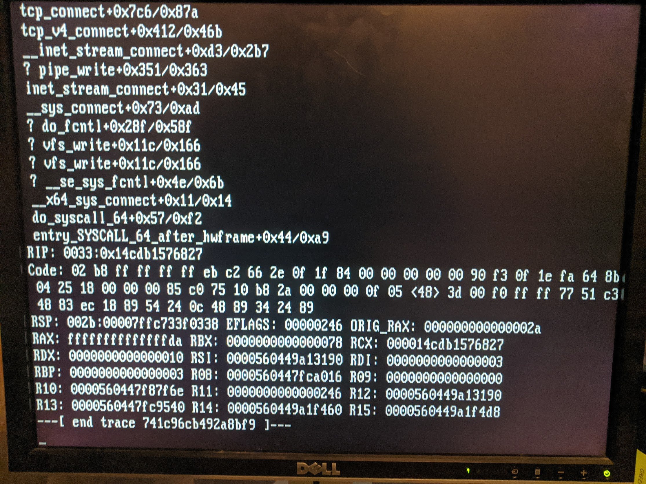

It appears that I'm having sporadic crashing/kernel panic issues on my 6.8.2 installation. This is a Dell R530.
No response to ping, to ability to ssh and the console was locked up. I did take a picture of the screen before powering off the server and powering it back on.
I ran the Dell diagnostics and nothing came back as bad in the hardware.
Any logs or anything I can enable to capture the full panic for help in troubleshooting? Anything I can post after a reboot to capture the issue?

Don't see nothing on the log, you can try safe mode with all docker/VMs disabled and/or downgrading to a previously known working release, if still issues it's likely a hardware problem.

OK so this takes about 5~ days to crash everytime. I've stopped every Docker and just had another crash.
Dual Intel(R) Xeon(R) CPU E5-2630 v3 @ 2.40GHz
64GB DDR-4 ECC Memory
Embedded NIC is Broadcom Gigabit Ethernet BCM5720
Disks are a mix of 4 and 8 TB.
I've run the Dell Diagnostics and all the memory checked out fine. There were no issues detected in the HW scan.
I've been running UnRAID on this for almost a year now. Troubles seems to have started just a few weeks ago.
I'm going to roll back to 6.8.1 and see if that helps.
Anything else I can provide to help out?
This seems to be one of the kernel panics.
It seems to be revolving around the macvlan stuff maybe?

This week I also plan on upgrading the server BIOS etc... to get everything up to snuff as well.
Macvlan call traces are usually caused by dockers with a custom IP address.
The only dockers I have running right now are on br0 with custom IP's. Is that a support configuration? Should I drop everything back to bridge mode and see if that is the issue? Or is there something else going on here?

OK so use by reverting to 6.8.1 I've had no more issues with kernel panics.
So is there anything in 6.8.2 that would have changed to cause issues? And would I be better off sitting at 6.8.1 or jump to 6.8.3?
