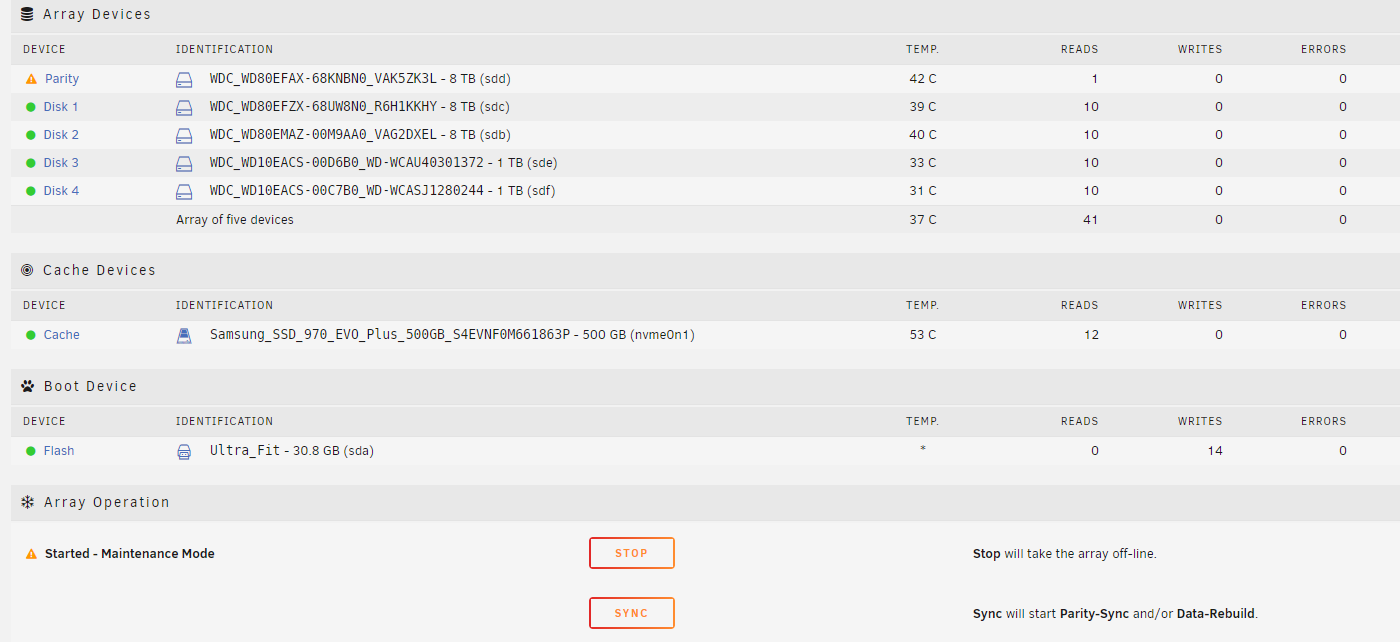

Ok. the WD 1tbs are installed.
Array started in maintenance mode, with the drive allocations as posted above.
Next steps?

This is more than I wanted you to do. Post new diagnostics.
What we had in mind was New Config with the invalidslot command. I don't know how this plays out now with the array already assigned and in maintenance mode.
