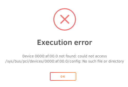

Starting the unRaid Server this morning, it failed to start MacOS VM. See error message, (image).
I restarted, same error message.

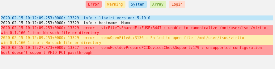

Then restored a 2 day old libvirt file, same error message. See libvirt log, image.

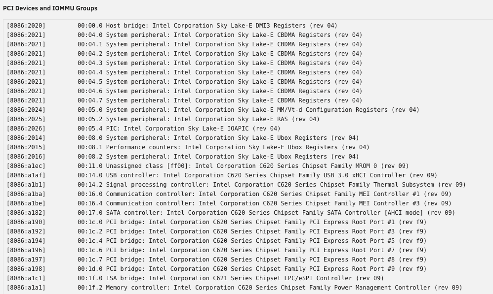

PCI Devices and IOMMU Groups looks different, see image.

Is IOMMU / vt-d enabled in the BIOS?
The issue regarding af.00.0 is that whatever that device was no longer exists in the system.  Could be related to a BIOS change
Thanks, vt-d was disabled, and it wasn't me.... 😞
