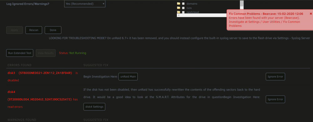

But today 1 of my new 8TB which passed a full preclear has started showing up with an error.
I have checked all the cables they are fine I have tried cables that work on other drives, so I know they are fine.
I have rechecked they are all seated correctly I am unsure why this has just failed!
It say
divice is disable
contents emanulated
click to spin down
Has mixed message says passed but shows a Smart Error

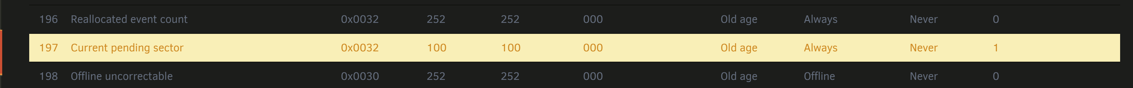

You should post the diagnostics instead of screenshots, but there's a pending sector so likely a disk problem, you can run an extended SMART test to confirm.

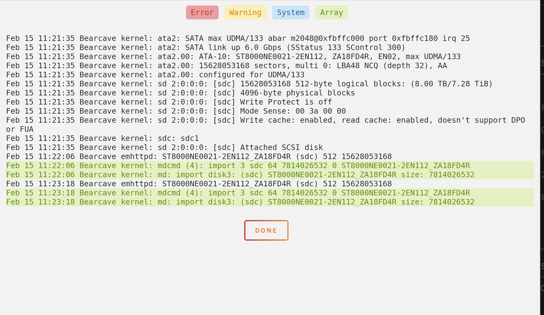

Running test now here is sys log
syslog.txt

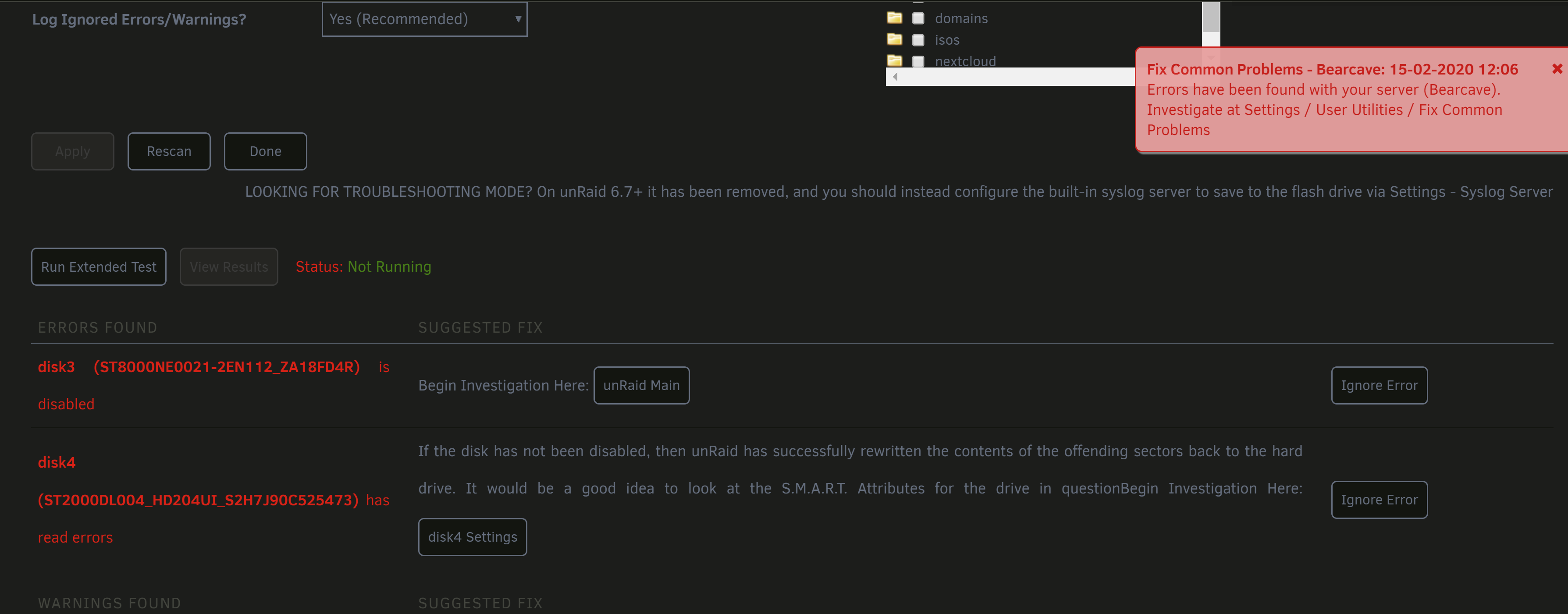

Since in the OP you only mention one disk I didn't notice at first that there are problems with two disks, the pending sector is from disk4, that's the one that looks to be failing, and the syslog confirms it was likely a disk problem., disk3 was already disabled since boot so we can't see what happened, but that one looks fine, extended test takes several hours, also start one for disk4 and when both finish post new diags.

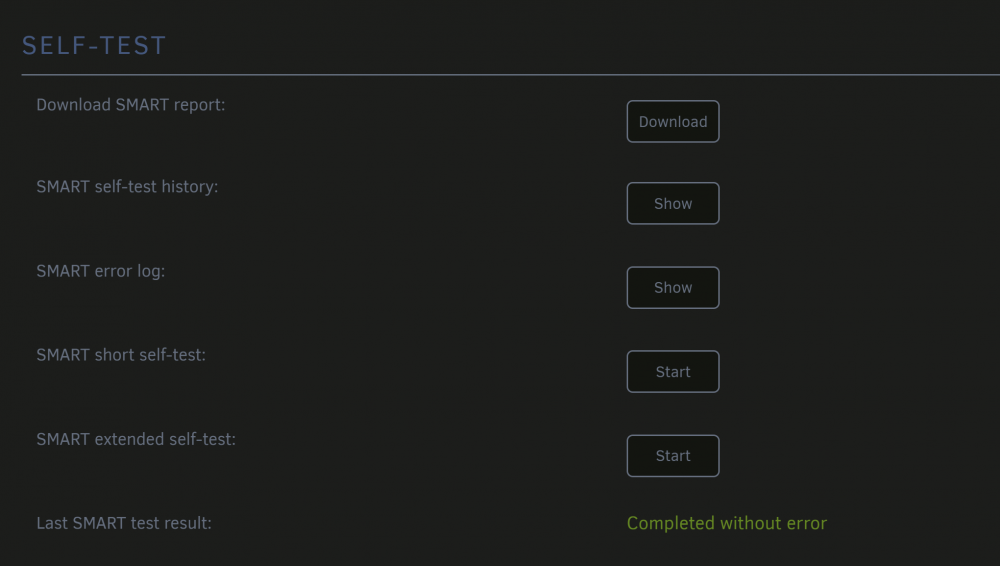

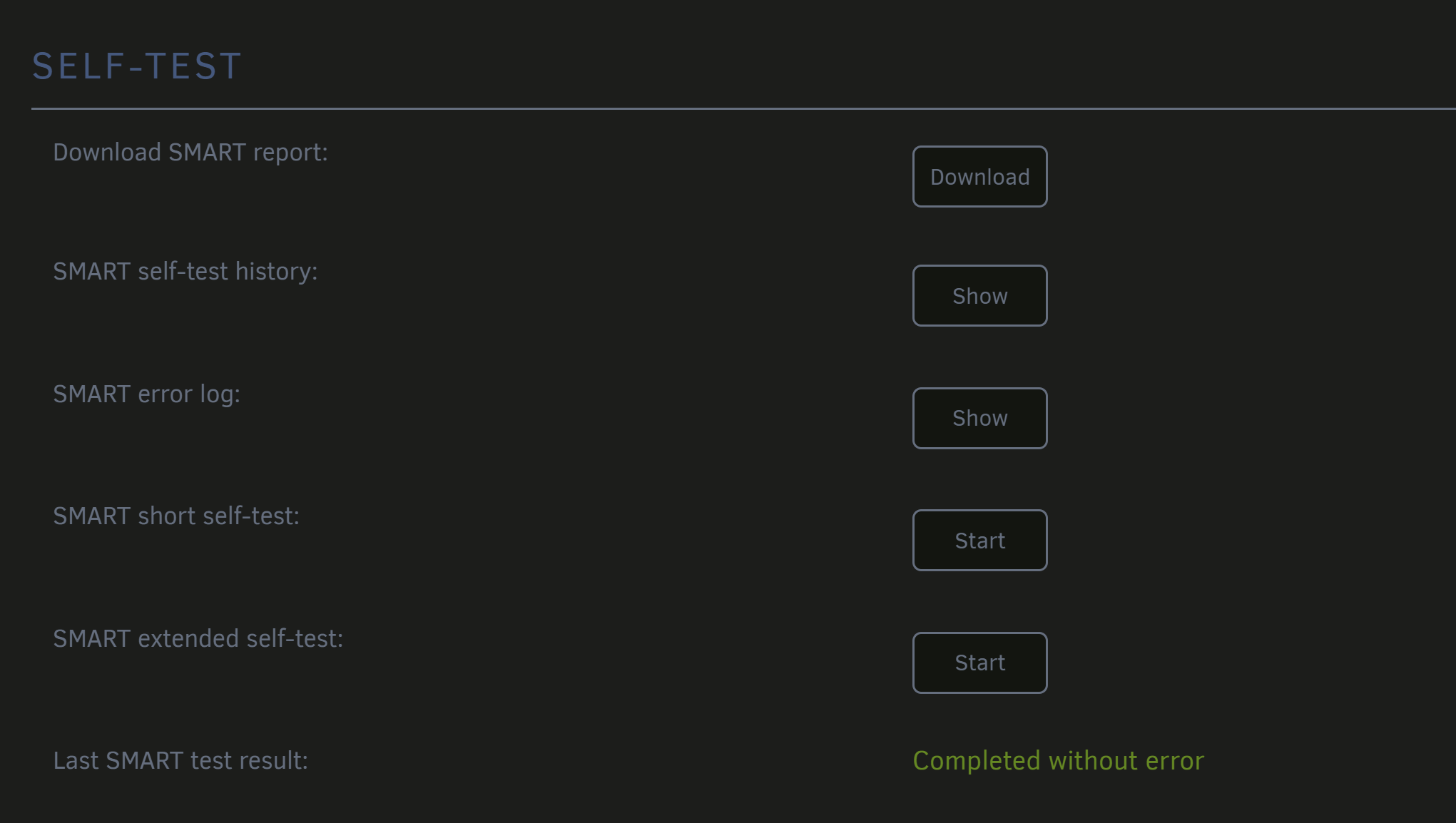

Disk 3 had a short and extended and passed fully
Disk 4 passed pre clear but fails instantly on short Smart Test.

Don't understand what you mean by this, disk is disabled but it's online and looks healthy, on the other hand and like suspected disk4 is really failing.
Both disks 3 and 4 look empty, if there's no data there best way forward would be to do a new config without disk4 and sync parity.

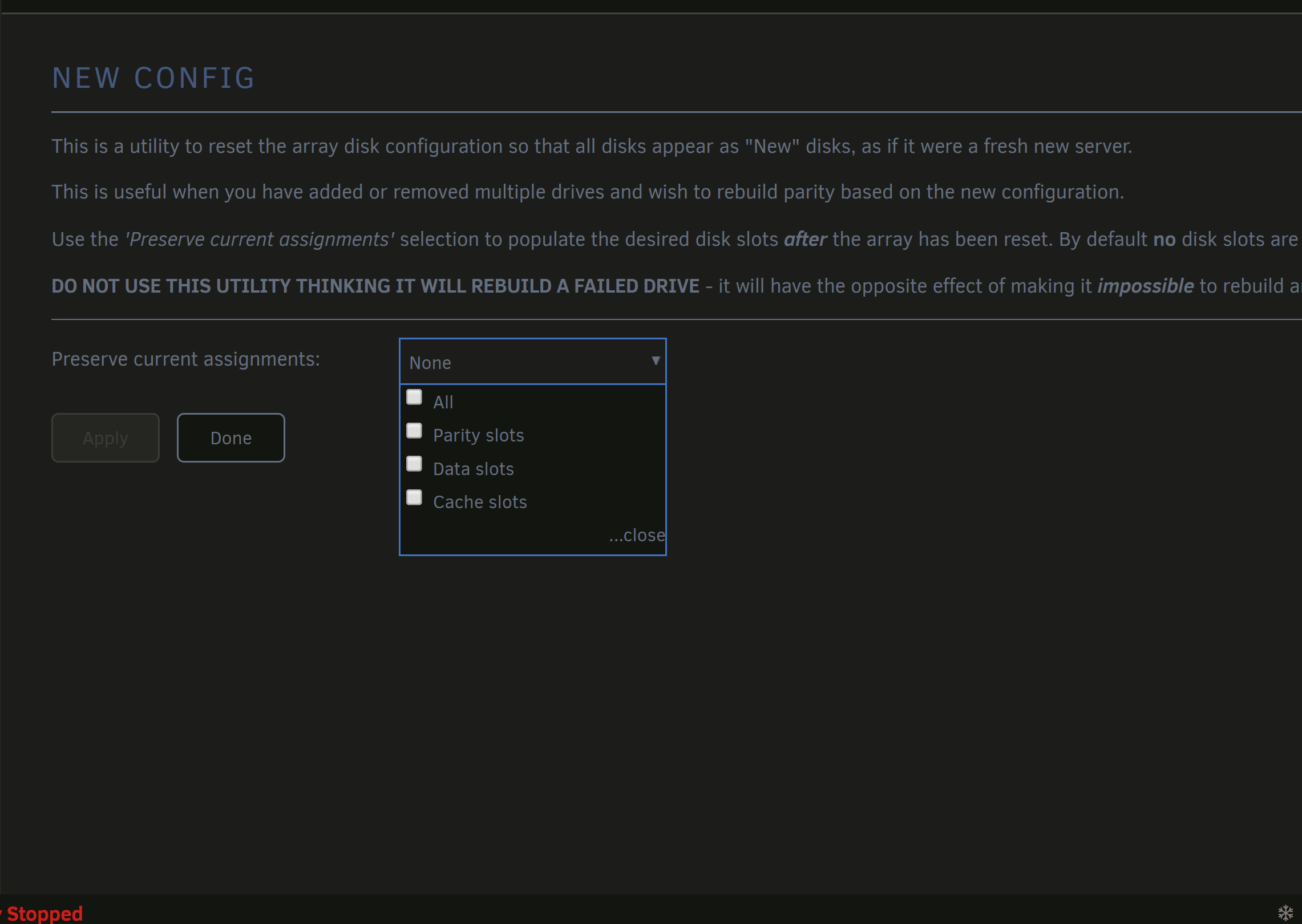

Like I already mentioned disk3 is just disabled, it still being detected and SMART looks fine, you need to re-enable it, you can't do that by rebuilding on top since disk4 is failing, but if both disks are empty like it looks like, you can just do a new config without disk4 and rebuild parity.

imageproxy.php?img=&key=e5eec7c5c933ca16imageproxy.php?img=&key=e5eec7c5c933ca16DO i select none here
Edited by OsoPolar
You can select all but then unassign disk4 before starting the array, also check that disk3 is correctly assigned, it should be.

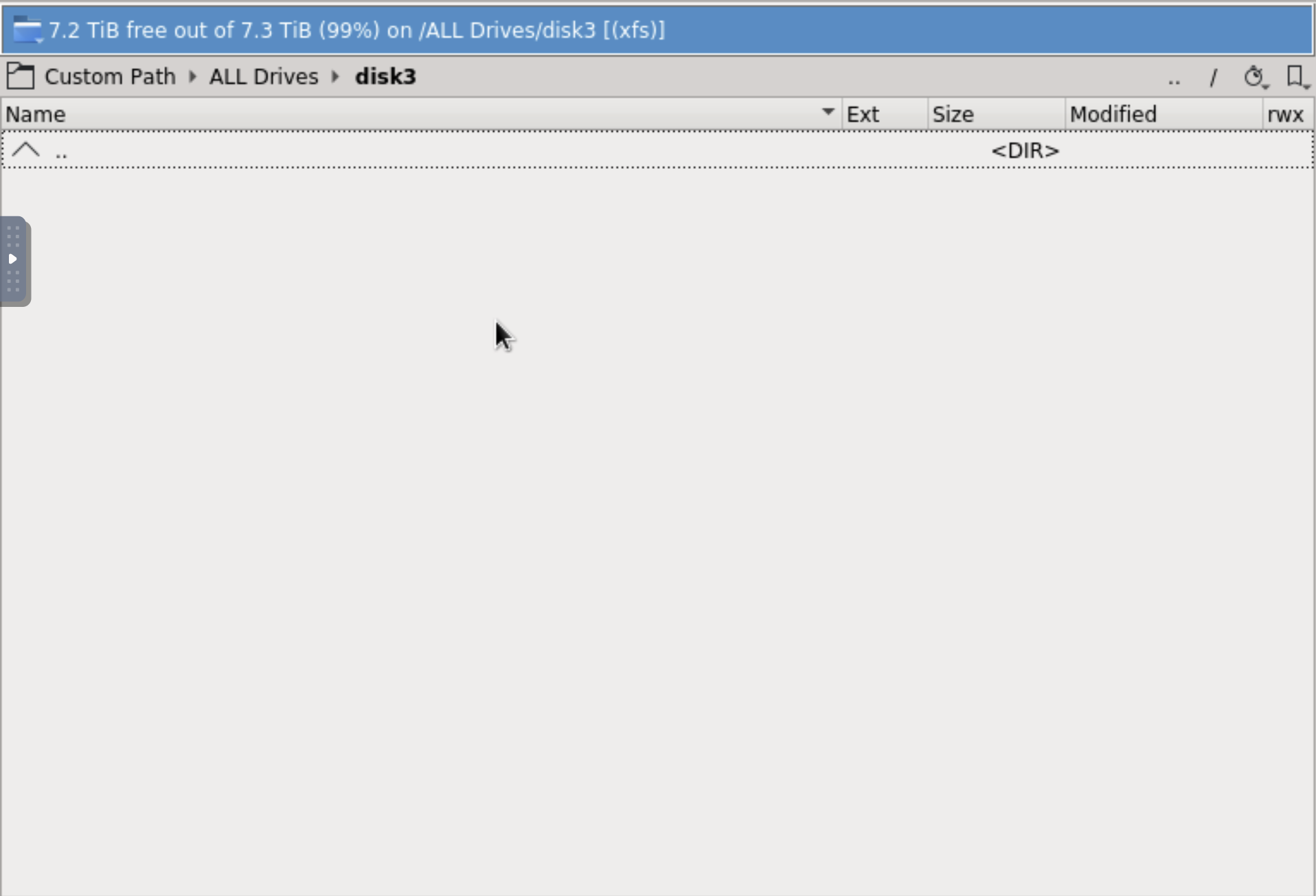

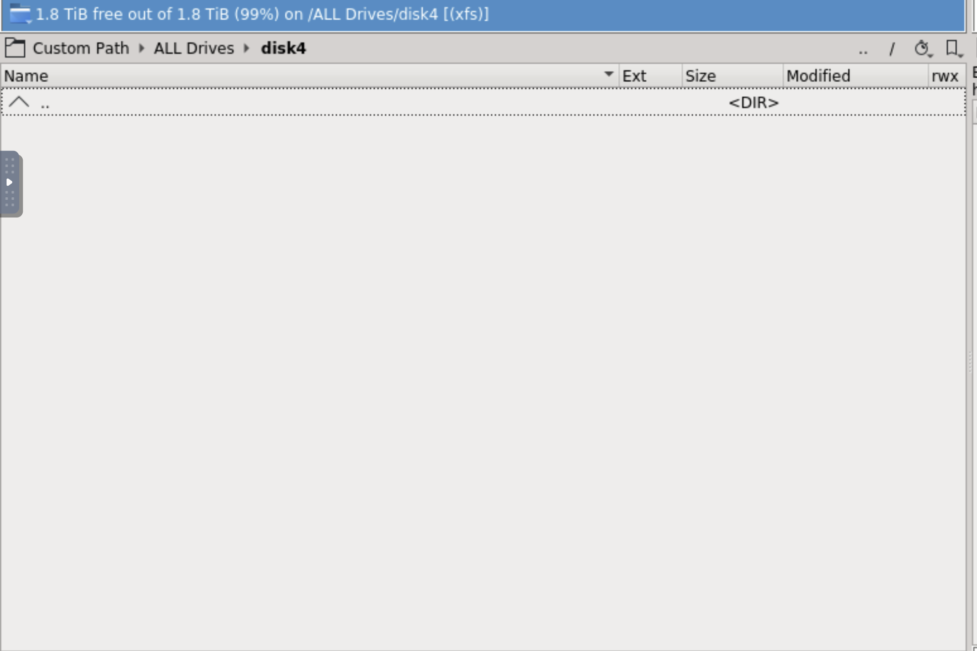

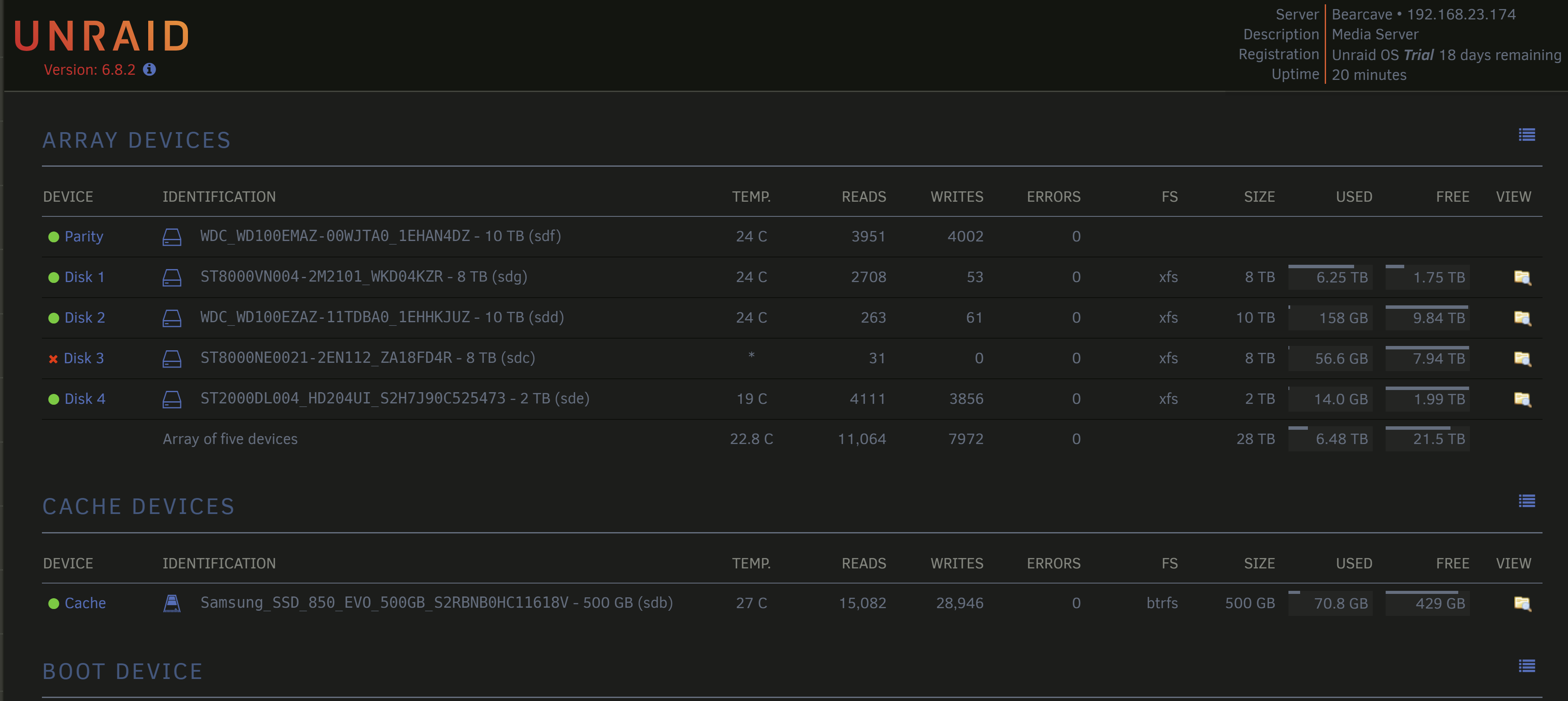

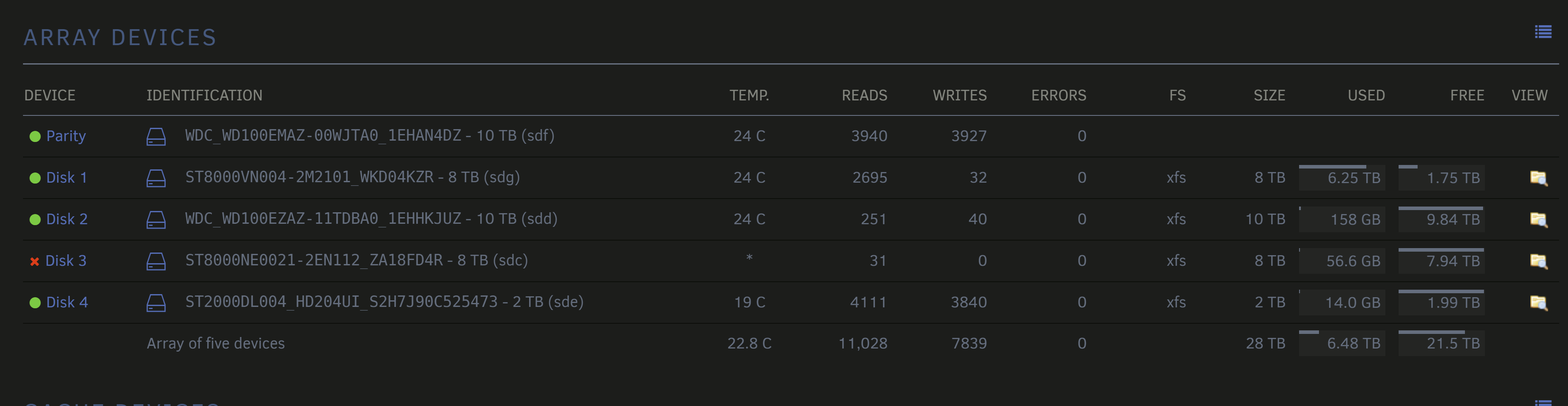

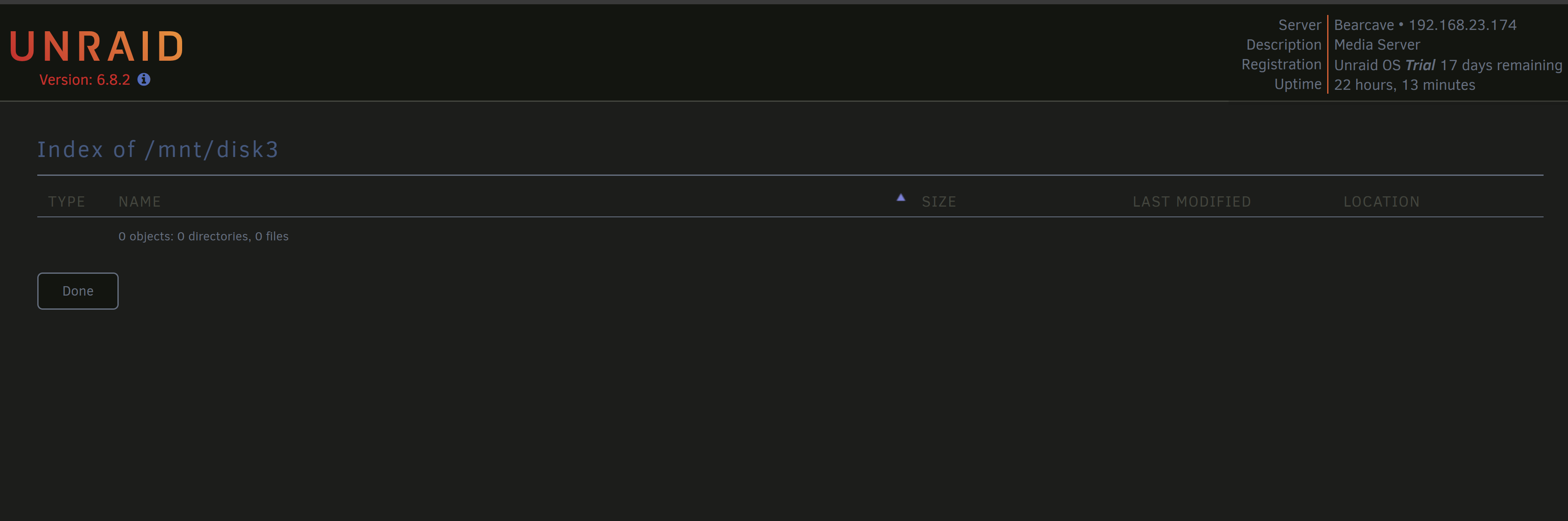

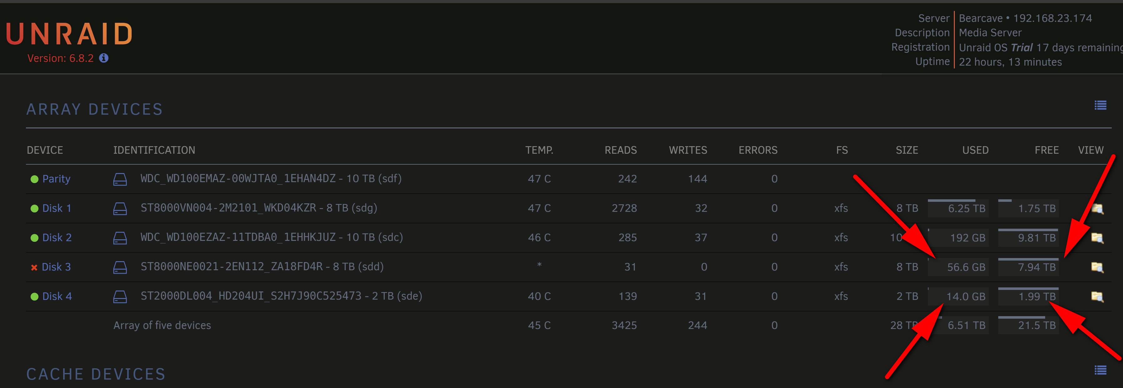

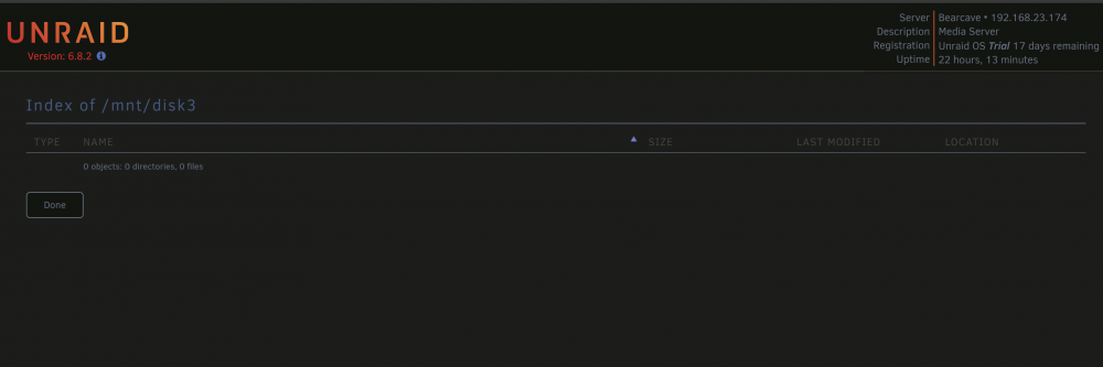

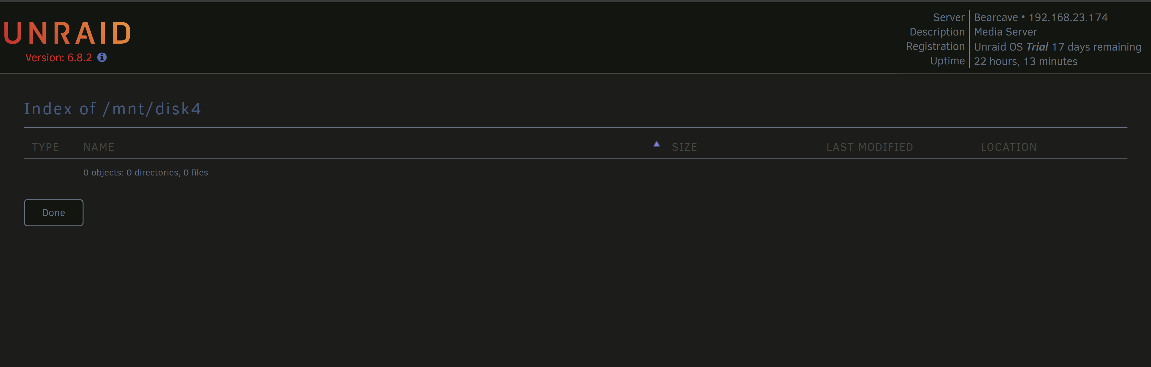

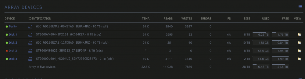

I have some confusion with what Unraid is showing.
If i check the drives they are blank but on dashboard they look like data is in them ???
Also double check with Krusader
I do not want to lose any data but looks weird reporting from dashboard
A small amount of space is used when you format a drive to create the structures for an empty file system.   The values you highlighted look typical for that.
Yes, a few GB are normal for empty XFS, forgot to mention, it would be a good idea to replace/swap cables on disk3 just to rule them out in case it gets disabled again.
