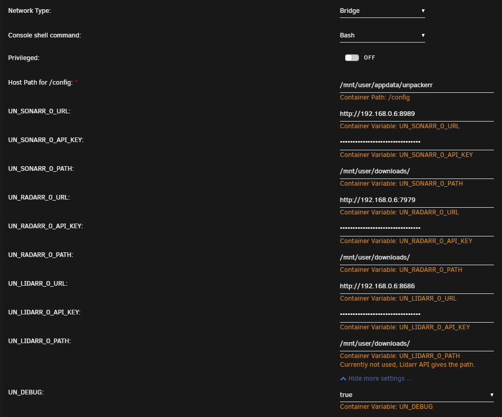

The only thing I can think off is the download path?
Which points to my Unraid Unassigned drive - top level download folder same as

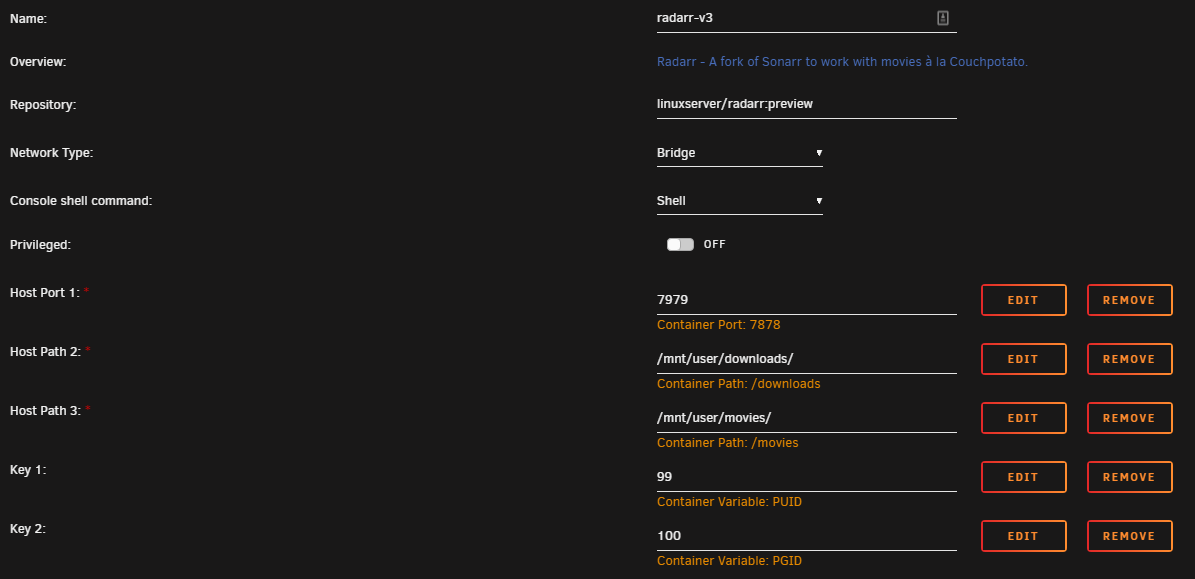

And my Radarr settings:
I have also tried writing the full path but still dosent work...
/mnt/user/downloads/tv/
/mnt/user/downloads/movies/
/mnt/user/downloads/music/
Is it scanning the folders even if Radarr & Sonarr haven't registered a download?

You should configure your paths correctly as they are inside the container...
You aren't even mounting the volume in unpackerr container?

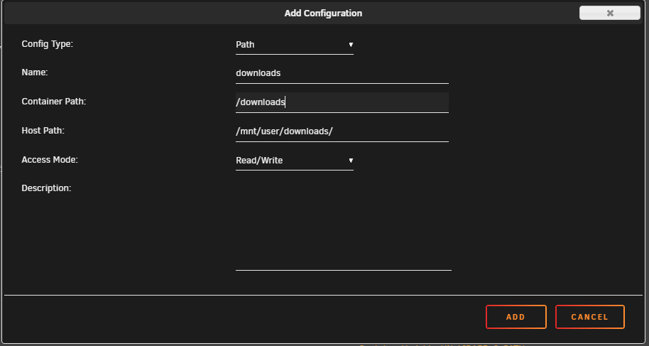

And then change the path in the docker to:
/downloads/tv/
/downloads/movies/
/downloads/music/
I can't know for sure what paths you use or prefer using...so it's a bad idea to include them in the template. I think your last solution is going to work....

Sorry I just need to know if the mappings in the docker is going to be subst for the "mount" like:
/downloads/tv/ --> ( /downloads/ = /mnt/user/downloads/) --> /downloads/tv
Or should they be "spelled out in full path" in the docker UI so they have the full path: /mnt/user/downloads/tv?
These 3 fields:
Sorry for the many question if you have an example on how you have configured it then please share :-)

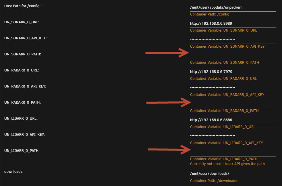

From the containers perspective...if your download client puts the downloads in the volume /downloads and radarr sees them in /downloads, then unpackerr needs to have the path set to /downloads and the volume should also be mounted in /downloads, whatever you did to get it working with radarr, the same applies to unpackerr. The variable ....0_PATH just tells unpacker, "go look in this folder". I also like to suggest to read whats written on your screen, the fact that you are adding a red arrow to the UN_LIDARR_0_PATH suggests you didn't read the orange text....
Yes I actually did - have spend allot of my time to get this to work.... and currently could mean that at some point it will be used so doesn't hurt to fill it in right!
Currently not used, Lidarr API gives the path.
It's already removed from the updated template, at this moment it likely never will be used.
