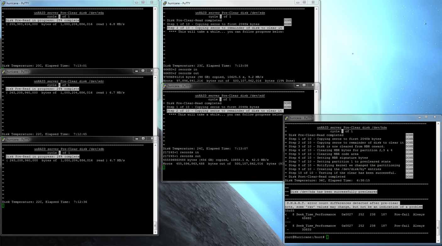

Sidenote: I'm zeroing all the drives now, and doing a parity check. The 4X Samsung drives connected to the RocketRaid card seem to share bandwidth nicely, each is at approx. 6.7MB/s, current parity sync is at 6.6MB/s. The 2 Samsung drives connected to the Promise card (came with a Maxtor drive) aren't playing so nice. One is at 42MB/s and the other is at 9.2MB/s. The smallest drive connected to IDE is already done, averaged between 30-50MB/S. (See attached screenshot).
Since I now have all of my drives running, is this an indication of the type of performance I can expect going forward? I feel like I must be doing something wrong, since non-parity writes were between 50-30MB/s, and then parity dropped it down to 1MB/s. As I mentioned, I will most likely put the IDE drive as cache when my registration key comes in, so slowER parity writes in the 15-20MB/s range won't bother me. I knew that was a risk using such old hardware. BUT, at 1MB/s, it would take 13 hours to write a Blu-ray .iso file. At current speeds, it's taking 80+ hours to run a parity check on *1* data drive. What happens when I put all the drives online?
Thanks in advance for your help.
