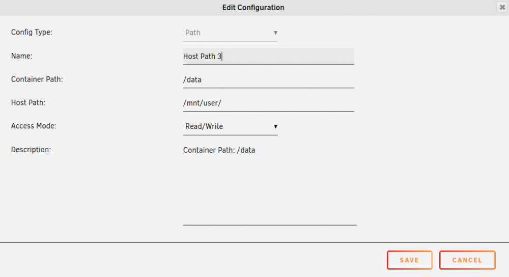

Therein lies the problem, I have multiple paths to map to Plex, not just a single 'media' user share. The key to get this to work is in the 'Host Path 3' settings on the new Plex container (not the old LimeTech one). I've attached a screenshot of my settings, I believe this points Plex to all of your user shares, so that in Plex you can then specify Movies vs TV vs whatever for each library.
What is also confusing is that Plex will display a file's path as starting with /data, even if you don't have any user shares named 'data'. I thought this was an error, but it seems like that is just how Plex works - you specify what path to point to /data (with the Host Path 3 settings), then internally in Plex it will refer to this path as /data going forward. So for example, my Movies library in Plex shows the path /data/Movies, which looks wrong but is actually correct. You can think of this like a shortcut inside of Plex, anytime Plex writes /data it is actually using the full path that you specified, which in my case is /mnt/user. To effectively, /data/Movies is the same thing as /mnt/user/Movies. Confused yet?

So I think I've got this working. Unfortunately, since I did it wrong the first time (following Spaceinvader One's settings verbatim), Plex added my library full of broken links, so everything was visible but I couldn't play anything. Now that I've fixed it, I'm running a library scan, which should fix all of the broken links. I'm finding some stuff will play and others are broken, but once the scan finishes I believe everything will be back to normal. Annoying, but still better than losing the whole library and starting over.
I have 4 or 5 shares I set up for my media: 2 "TV" shares and 2 or 3 "Movies" where between the TV and Movies share I have folders set up to allow me to export them to the plex container as either Read-Only or Read/Write permission.  For example, "TV" share has a "wtv" folder (my migrated recordings from windows media center) which I do not want plex to "accidentally" delete - this is exported as RO. Then I have a "recordings" folder which I allow plex to save TV shows to and that gets exported as RW.
I guess my point is that you can export multiple "Paths" to the plex container rather than your entire user directory. You just add another path when configuring the container and set the host path to your unraid-side media share/folder (i.e. /mnt/user/Movies) and the container path to what you want it to appear as within plex (i.e. /Movies).  You'll then need to configure your Library in plex and tell it to look in "/Movies" for your movie library and repeat for each exported path.
Thats because you exported your directory "/mnt/user/" to the container as "/data", as seen in the screenshot under Container Path.  You can rename it to anything you'd like and that is what it will appear as in plex.
Just my 2 cents about how I have it set up and what can be done
