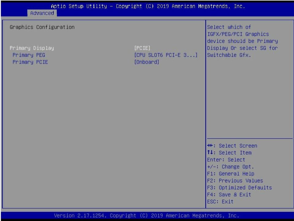

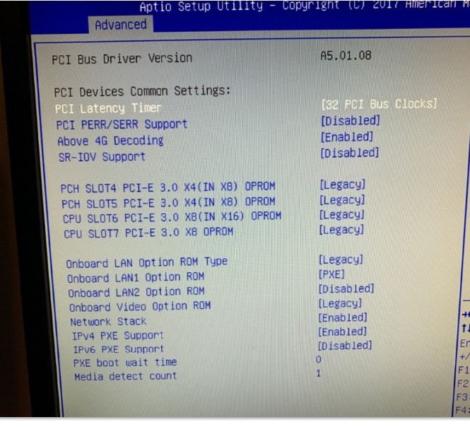

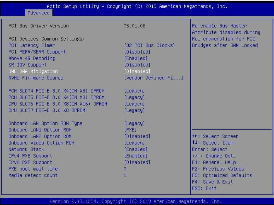

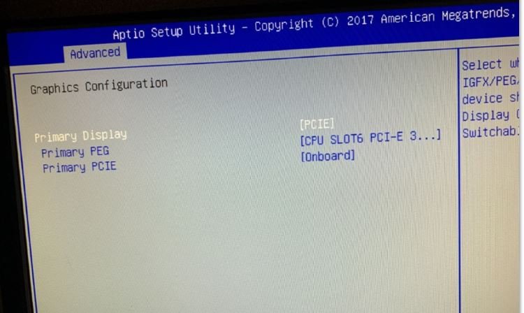

I just went back and checked the bios settings and I do not find anything to change.  There are a couple of new options in the bios after the update, see attached pics.  Thanks for the info on the igpu.  I'm using the vga port on the motherboard connected to a monitor.
I do have a ticket open with Supermicro as well, but they have not yet responded to it.
Please take a look at the pics and let me know if you see anything that I should try changing.  After the bios update, I went back and changed everything to match what I had before.

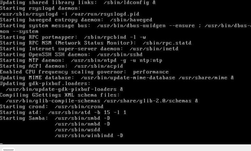

The last pic I included is the last screen I see on the monitor attached to the server, before it goes dark.
Thank you!
