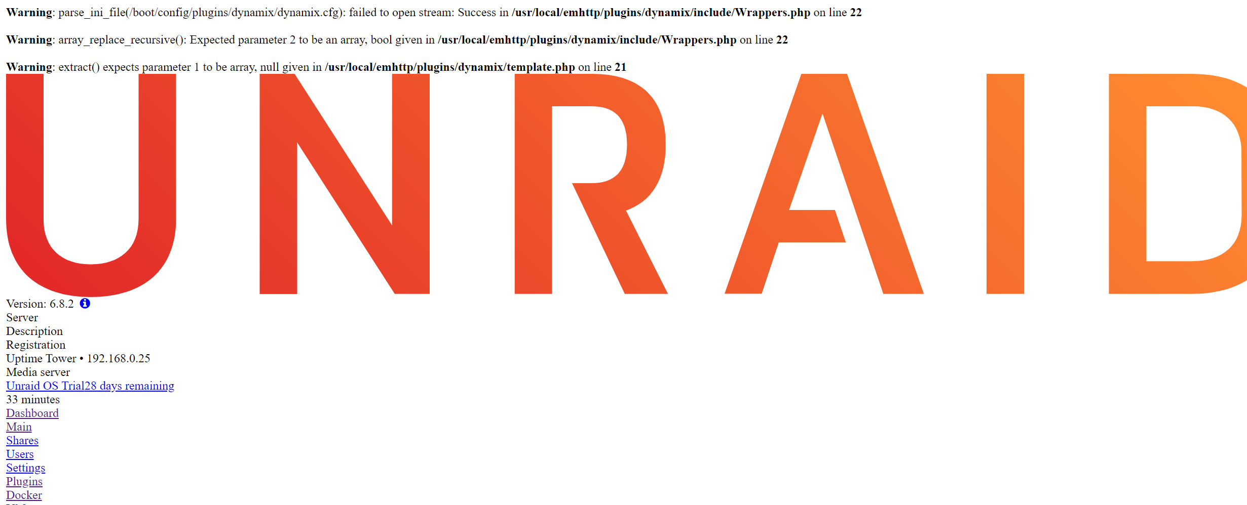

I very recently (as in a few days ago) set up my first Unraid experience, and everything was going fine, until today.
I installed Binhex-Preclear for some drives, and the second I installed the docker my page refreshed to what is shown below.
I found a few post's on here and tried those solutions and so far have had no success. I tried to boot in safe mode
without plugins, same problem. I tried to delete /config/plugins/dynamix/dynamix.plg, however i DO NOT have the
dynamix.plg file on the drive. Since this Unraid was just built I have no cache backups or anything yet, so I am hoping someone
is able to help,
Thanks for your time!

I have just ran diagnostics and have the unzipped file, what would I be looking for in it? I know the docker seems very unlikely, but I thought Id mention it because it was an odd coincidence.
I am using USB3, I dont want to say that isnt the problem, however it is a brand new drive and I am at least skeptical of that at the moment.

Yea i had done both of those, no difference.
Is it normal to not have a dynamix.plg file?

This improved the GUI a small amount, but overall, no change.

The errors are all still there sorry.
Thank you for letting me know about dynamix.plg, it had just come up a few times during my search.

Im sorry, im a little confused about what you are asking? You want to just see the file path without the contents..?
Dynamix.cfg containts nothing

Not the answer I was expecting, but still explains things
Deleting that file *should* get you going, but I'd expect that you've also got some corruption on the flash drive somehow.  Pull the stick and toss it into another computer and run the file system checks on it, or reformat and recreate it (copy from /config the trial.key file and save somewhere safe)

Thank you! Think seems to have fixed the problem. Part of me thought that this was the issue but I was unsure if deleting this would cause any problems.
I will backup everything and migrate to USB 2, as clearly this suggestion has merit.
