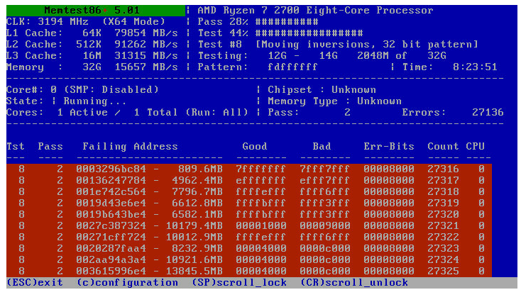

Memtest has been running through the night and has found errors. I'm not exactly sure how to read this or how long i should leave it running for.
You can stop it after a single error, it confirms RAM is the problem.
From the looks of it, I'm pretty sure you are overclocking the RAM controller, but I could be wrong. Make sure you are obeying the max speeds for the amount and type of RAM on that CPU.
Any errors at all are unacceptable, you need to change either the hardware or the settings until you get zero errors over a 24 hour runtime of memtest.
All settings on my system are stock. 4 ram chips from the qlc list. I will pull half the chips and rerun the tests with different combinations till the error is corrected.

I know this has been a bit. Took quite a bit of testing to narrow down the problem. My system is stable as long as I only have 2 sticks of ram slotted all the chips are fine as long as I don't have more then 2 in the system. I have tried two different CPUs and get the same behavior with both.  There was a bios update released so I updated and tried again and didn't get any change. I still have not been able to find the ram speed so I have reached out to the motherboard manufacture for assistance. For the moment running okay with 16gb or ram. Hopefully I will be able to get the upgrade taken care of at some point.
