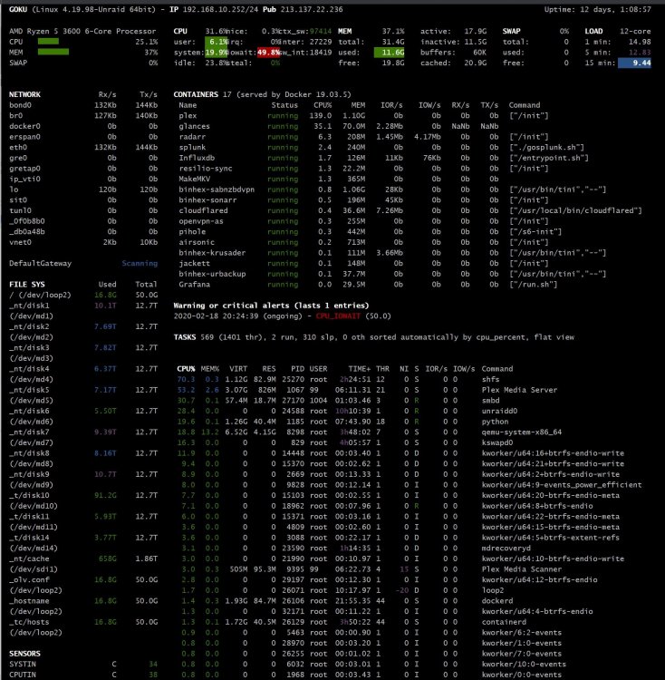

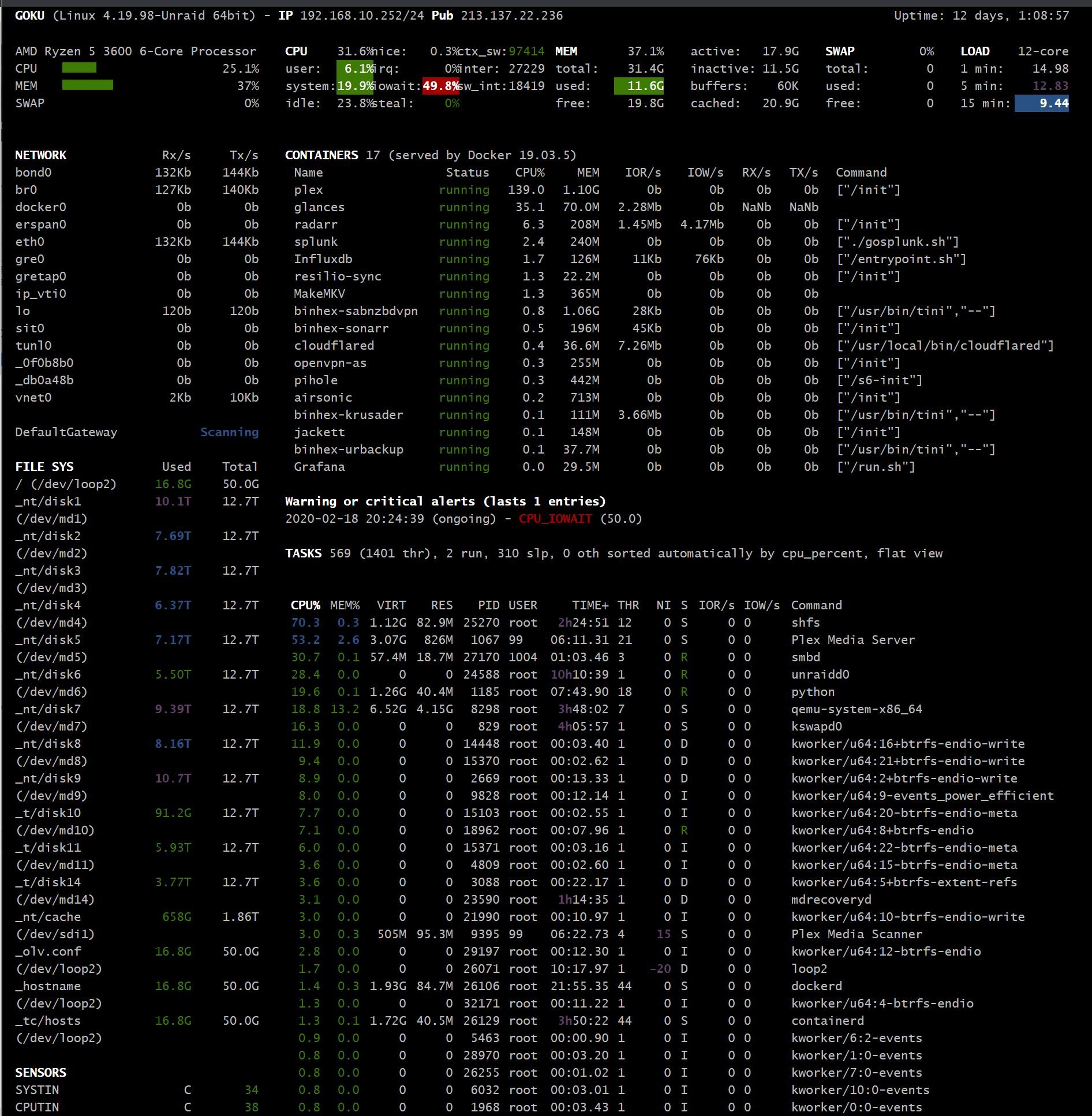

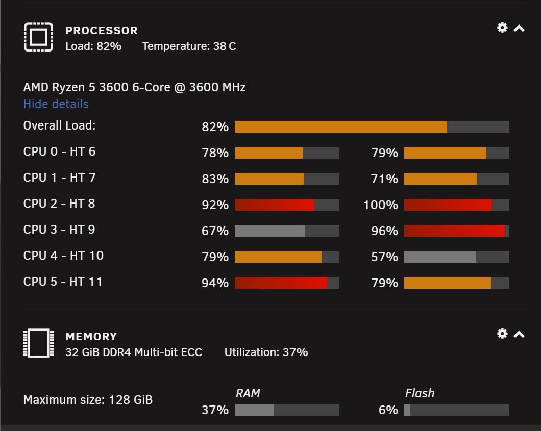

My Ryzen 3600 CPU is completely maxing out when copying large files onto my array (well to the cache drive...). This was a single 40GB mkv file.
Any ideas why this is happening?  I can see iowait is super high, not sure what it means?

I logged the exact same issue. Copying to a non-cache enabled shared doesn't have the same issue. No-one seemed to have an answer as to why.
I have observed similar behavior across several servers for a long time now and figured it was just a characteristic of the OS. It does this for me even as low as 35MB/s, but at the same time, I can also transfer 400MB/s, so it doesn't seem to be a bottleneck (even though I also see io wait)

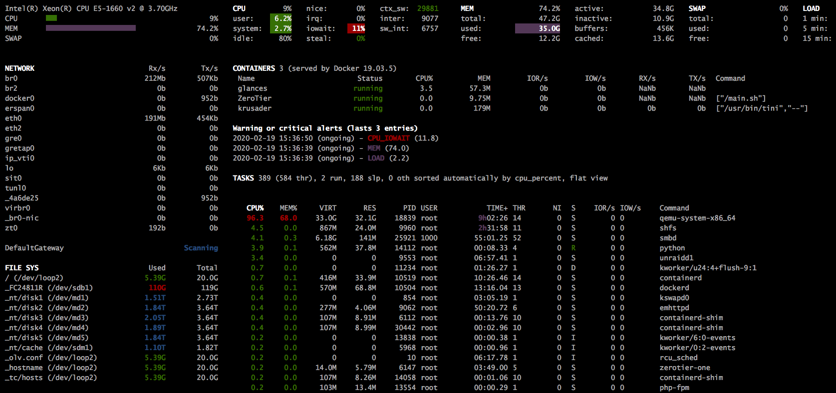

754595006_ScreenShot2020-02-19at3_39_27PM.thumb.png.247383593cdb32a3c20ab035c7065cfa.png1567455657_ScreenShot2020-02-19at3_40_12PM.png.8efd15857200a79e4fef6512ec12b3c1.png
Can't confirm this... when i copy ~41GB over the 10GBit-LAN to my cache-SSD, the CPU has a load of ~18-26%
It might be hardware-related...
