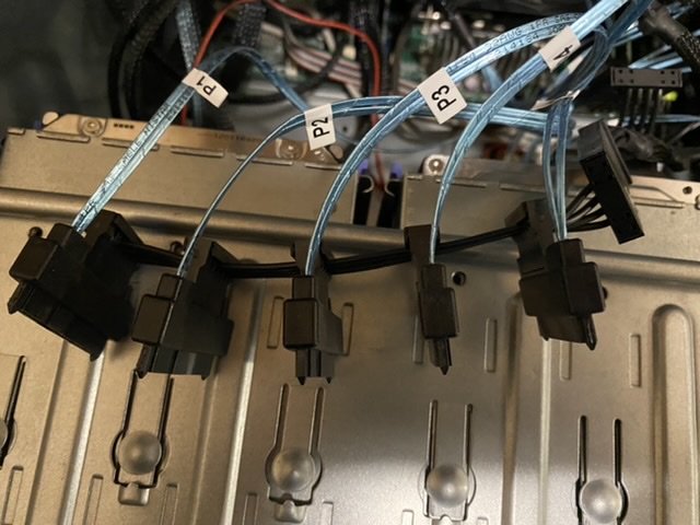

Can't see what happened to disk13 since it was pre-reboot, but at the moment there are errors on 3 disks at the same time, this suggests more a cable/power issue, do disks 8, 14 and currently unassigned ST2000NM0001_A2_Z1P16K7F0000C229EX7U_35000c50040fbab3b share something in common, like a miniSAS cables, power splitter, etc?
Yup, same power and same sas cable.

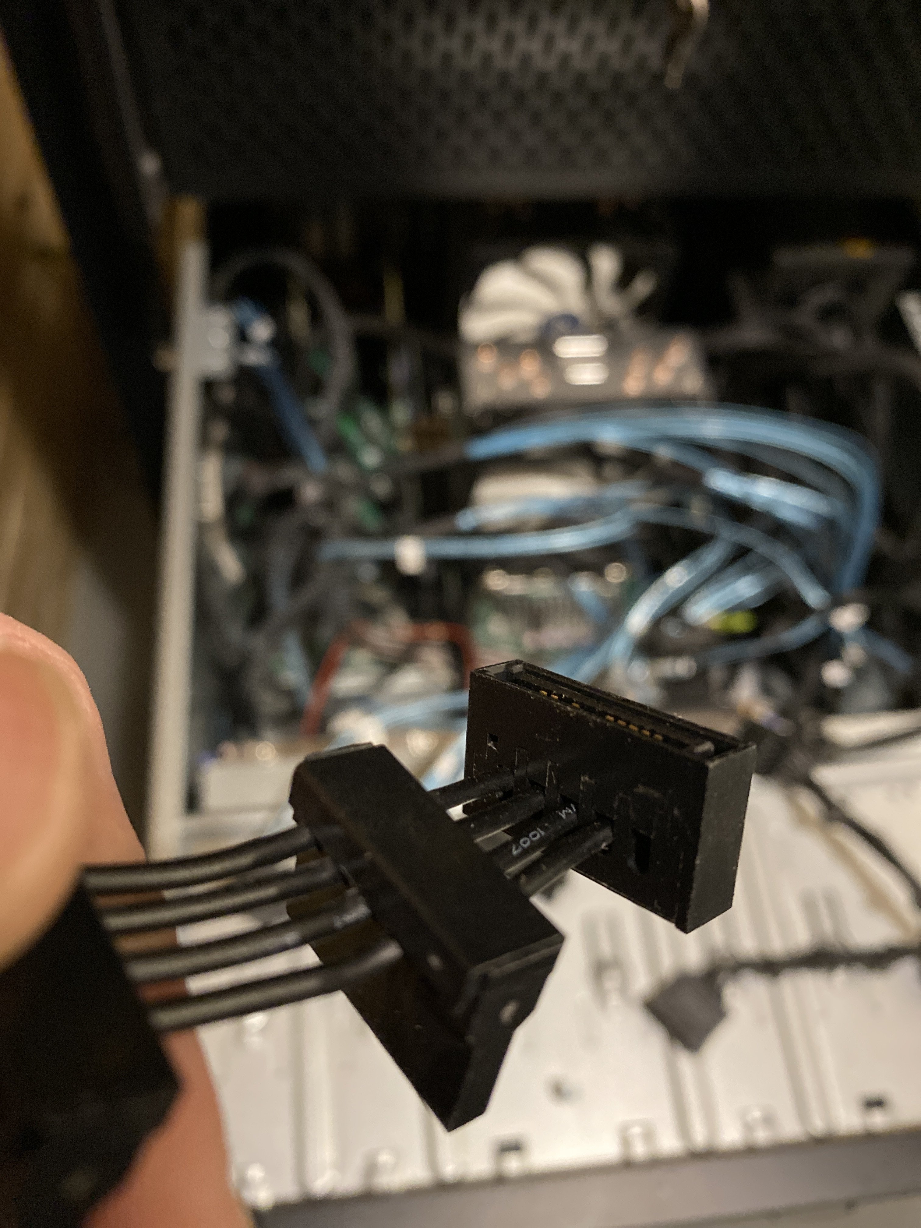

I took the power cable apart since I made it. All of my ends seem to be fine, but the wires on the feeding end practically fell out when I removed the cap. (From factory)
SATA splitter should be used for max 2 drives, more than that can easily go over the max 12v rating for a SATA plug, 4.5 Amps.
Ok -- I believe you.

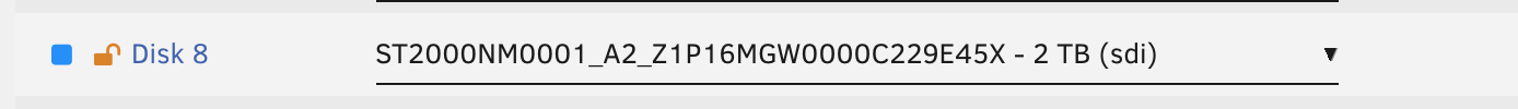

Now that I've fixed that power cable, I've rebooted. My problem is that I don't remember which disks were in slot 8 and 20. And no matter what disk I slide into that slot, it's marked blue, meaning it will wipe it and insert it as a new disk, right?
If that's correct, I think I need to do the following:
- generate a new config with those two slots removed
- let parity run
- when parity is complete, mount the two problem disks with UD and attempt to copy the files back to the array
Can you confirm that's a good course of action, or show me the right way?
If the dropped disks are OK, and you can run a long SMART test to be sure, you can do a new config with those disks also assigned, to any slot, then just re-sync parity.
