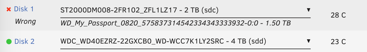

Since I do not have a parity drive and there's no rebuild process, how do I get past this? It won't let me start the array with the new one nor assigning no device to that slot
Tools -> New config -> Keep all assignments -> Apply
Then assign new disk

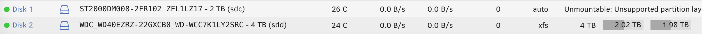

God dang it man I'm sorry to keep bugging you, but I did it and now this is what it shows me. I precleared the 2tb drive and it said the filesystem was xfs before I added it to the array
What said it was XFS? Unassigned Devices?
Yeah UD said XFS after I precleared it
Preclear doesn't format a disk, and neither does UD unless you tell it to. After a preclear a disk can't be XFS or any other filesystem
