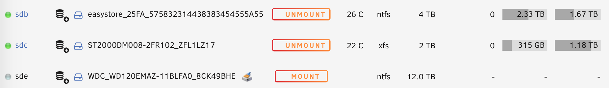

18 minutes ago, Aeonofgods said:
Yeah UD said XFS after I precleared it

1 minute ago, trurl said:
So where exactly does preclear fit into this narrative?
When my original drive failed I bought this 2tb drive. From all that I read it seemed as though I needed to preclear the new drive before I did anything with it. Originally it was NTFS but after the preclear UD said it was xfs (and still does).

3 minutes ago, trurl said:
My 1.5tb external drive failed so I bought a 2tb internal drive to replace it.
I missed this part before, in this case it's normal for Unraid to complain about the partition, since the now 2TB disk has a 1.5TB partition, and Unraid requires a single partition using the entire disk, but like mentioned UD won't mind.
You need to copy the data on that disk elsewhere, using e.g. UD, then you can add the disk to the array and have Unraid re-format it.
