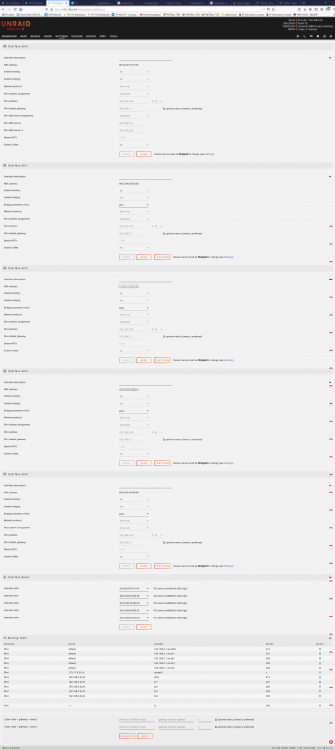

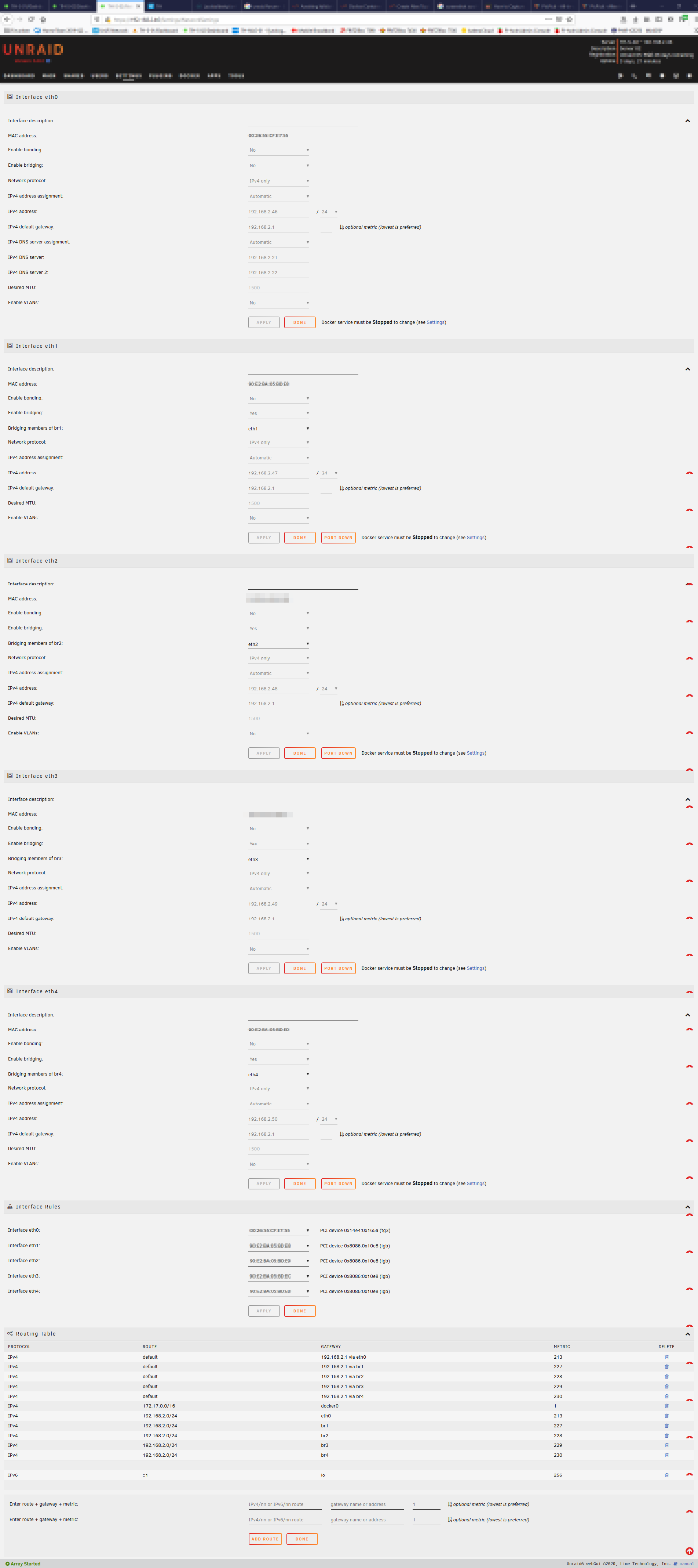

I'm using 5 NIC's, it's important for me to separate some docker container to a specific nic. So I created 4 bridges: br1-4. Unraid is accessible by all 5 IP-Adresses, it works. I tested it also with some VM's, each bridge is working.
My problem is, I can't choose them for docker-containers, only for VM's.
This is what I see on creation of a new VM:
and this is what I see on creation of a new Docker container:
and this is my configuration:
