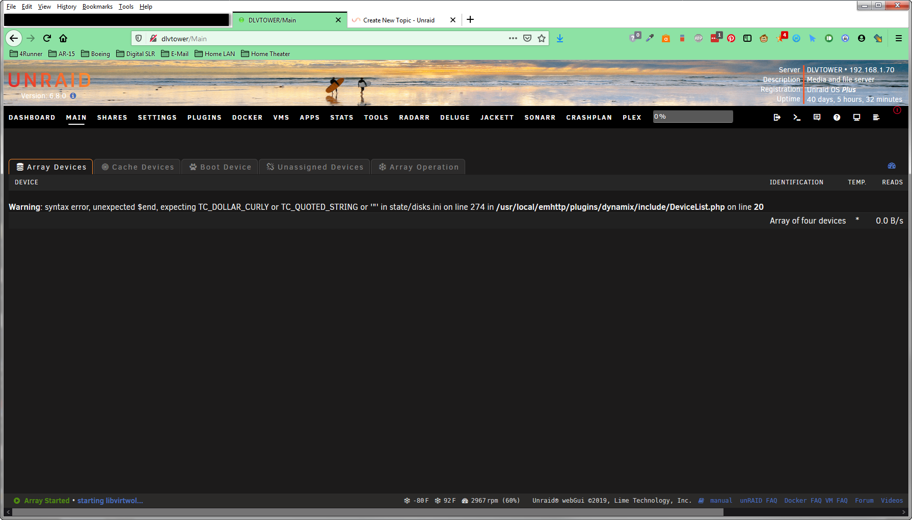

Error message from main page, array devices tab: (no information on page)
Warning: syntax error, unexpected $end, expecting TC_DOLLAR_CURLY or TC_QUOTED_STRING or '"' in state/disks.ini on line 274 in /usr/local/emhttp/plugins/dynamix/include/DeviceList.php on line 20

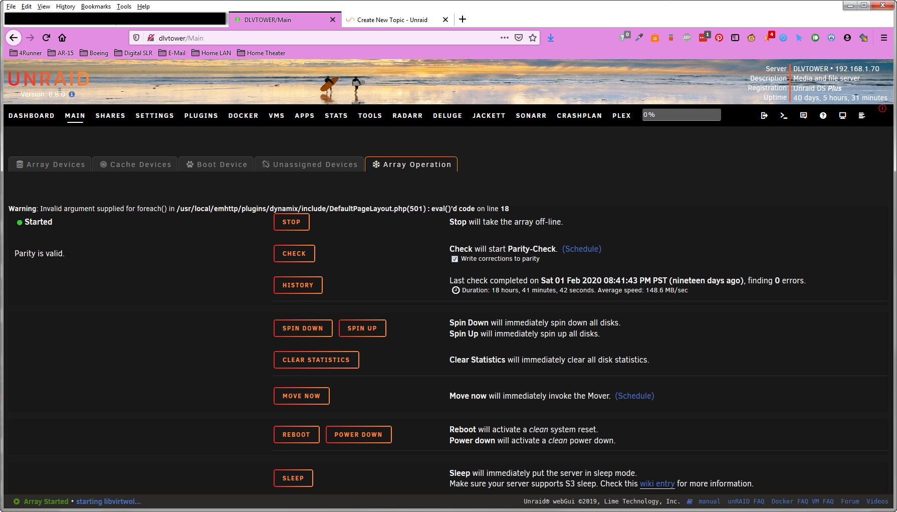

Error message from main page, array operation tab: (page generates, stop array button works)
Warning: Invalid argument supplied for foreach() in /usr/local/emhttp/plugins/dynamix/include/DefaultPageLayout.php(501) : eval()'d code on line 18

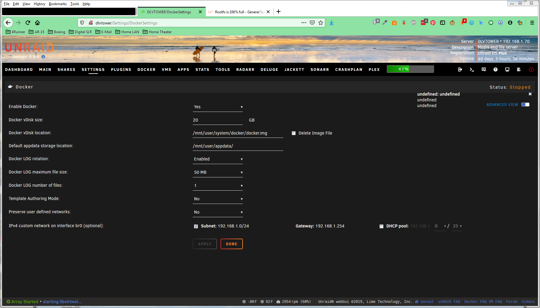

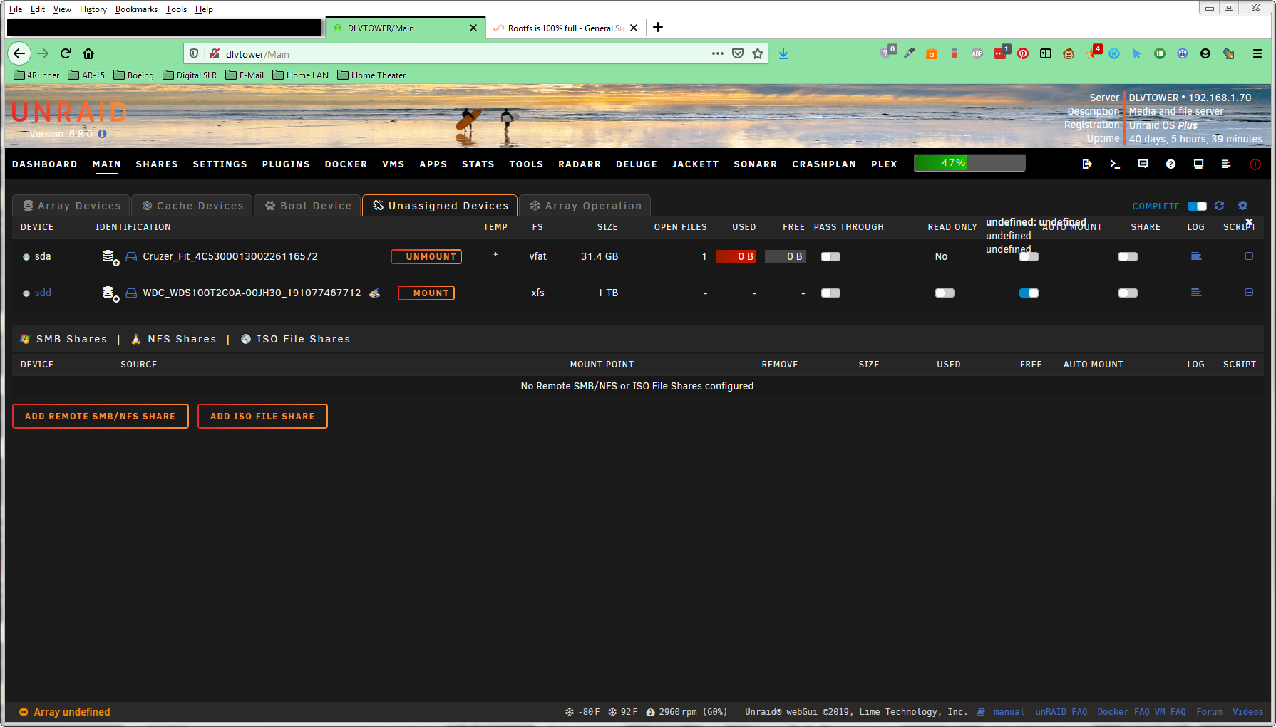

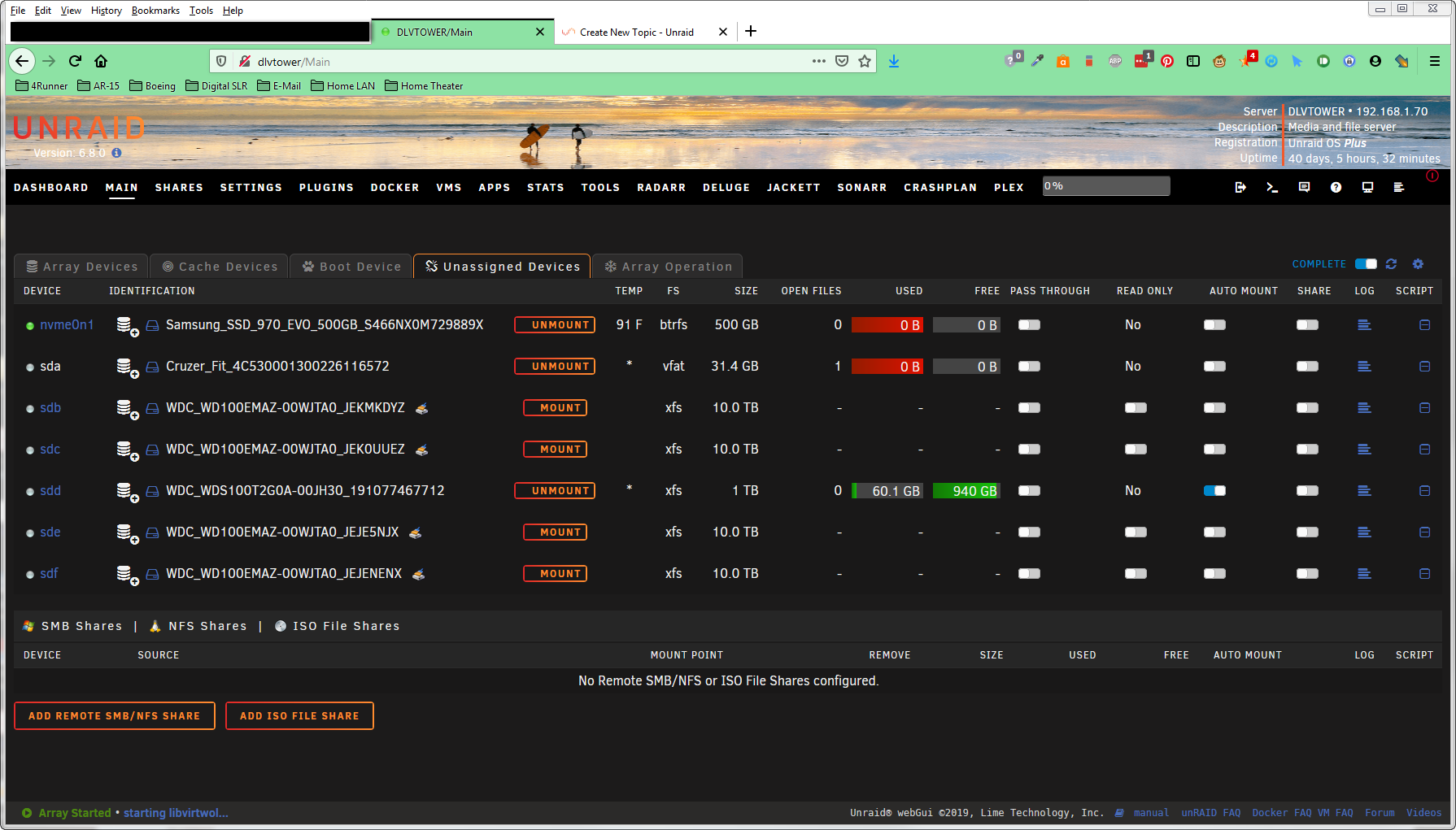

Settings - Docker - Disable the service.  Delete the image, re-enable the service

okay...so set enable docker to no...if I delete the image, am I going to have to set up all of the dockers again? I had a few customizations for plex, etc.? While I have docker enable set to no...should I consider increasing the size from 20GB default?
Edited by propman07
the appdata will be safe and the templates will be already filled out and reinstalled the same way.

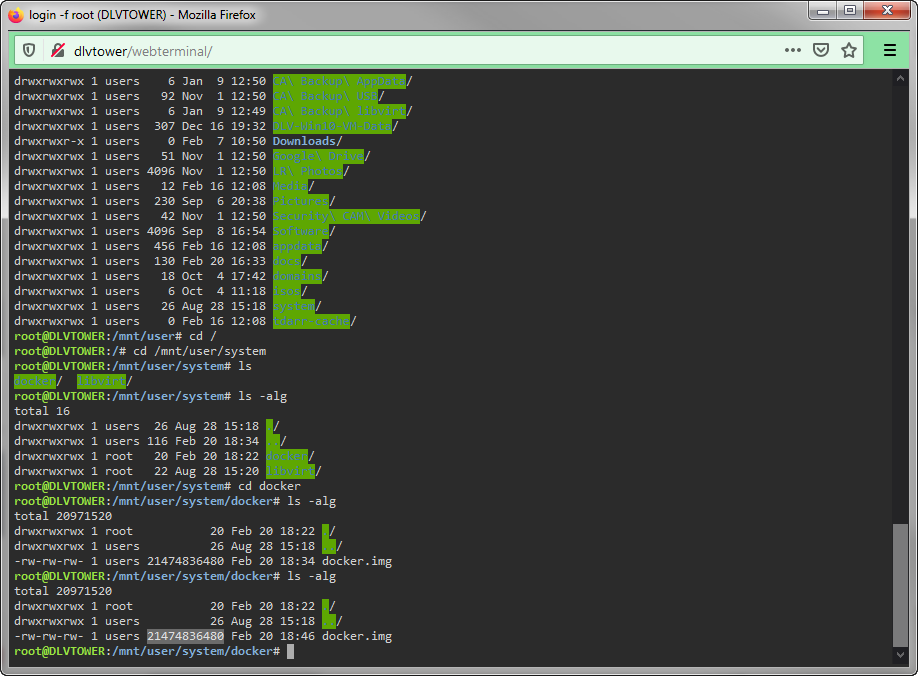

not sure how to tell....if I go to terminal, looking at size of docker.img file...21474836480, which I'm guessing is around 21.4 GB.

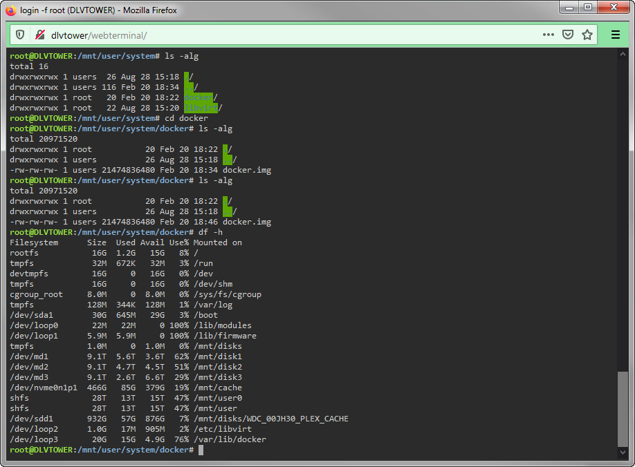

Just now, Squid said:
diagnostics would tell
or
df -h
df -h screen shot attached
One problem fixed.  Now wait and see what happens
Okay. So it looks like deleting the docker image and re-creating it fixed part of the problem...so I'll have to wait and see about the other two.
