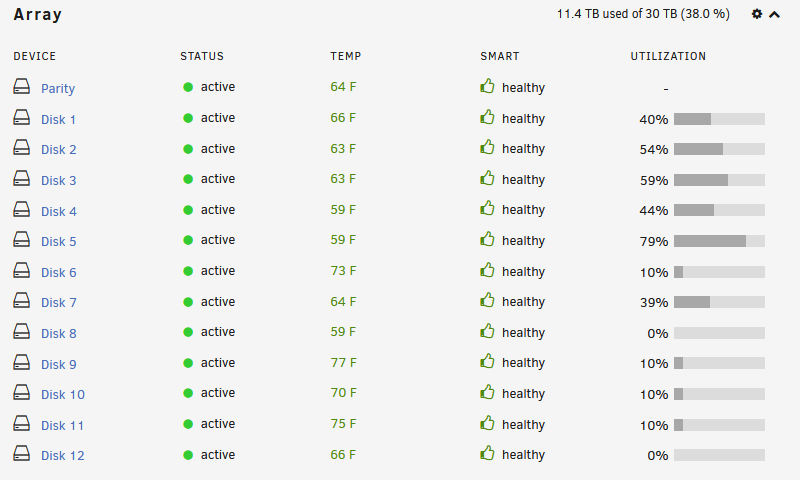

You have a lot of disks so I haven't looked at SMART for all of them. Do any of them have SMART warnings on the Dashboard?
Is this good enough, or is there a need for me to dive deeper into the smart logs?
9 hours ago, wickyd said:
Is this good enough
That looks fine.
