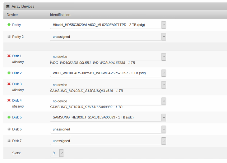

unfortunately, I broke my flash drive and realized I only have a backup with an outdated disk assignment.
Recovered the backup, replaced the key
My parity was assigned correctly as were 2 of the other 5 hdds.
The 3 remaining drives cannot be assigned.

In the meantime, I figured out I did report something wrong.. The 3 missing drives are 1TB each. But the 3 suggested drives are 3 TB each. This really confuses me as I cannot exactly recall the last changes I did to the array.
While I m pretty sure that the 2TB is still the parity (yes that would mean that the 3TB drives only used 2TB of its capacity so far), is there any other option to verify the parity drive? Any comand I could run?

If there are 3TB drives in the parity array, one of them MUST be the parity, which means the 2TB assigned to parity in your first screenshot is really a data drive, not parity. Unraid will not allow a smaller drive to be assigned as parity.
Go to Tools, New Config, preserve none, then go back to the Main tab and assign all the drives as data drives, DO NOT POPULATE either of the 2 parity slots, they must say unassigned.
