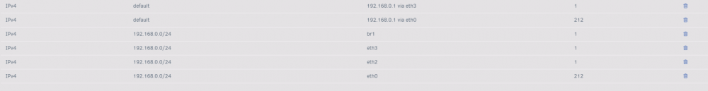

Not sure why this has suddenly gone cockeyed, but I normally set my NICs up as statics from an unRaid side. But when I do this it seems like the routing goes a bit weird. When set to static with the router set as gateway and DNS I get this in routing and the interface will show as down with the message check cable.
If I say change etho0 to automatic (and use the router to set the static IP by MAC) the routing updates to this and I can break out correctly via the router:

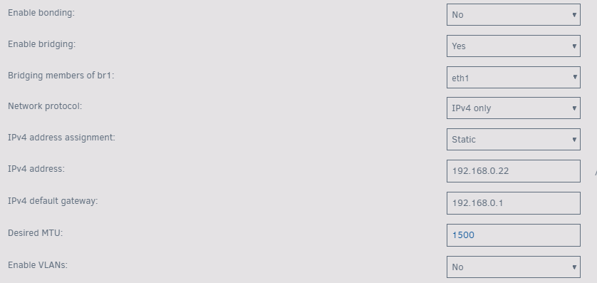

Here's the example network setting for one of the NICS:
All NICs plugged into a flat switch into the LAN port of said router. It's not the biggest thing in the world as I can set statics from the router, but it's annoying me that I don't get what I'm doing wrong.
