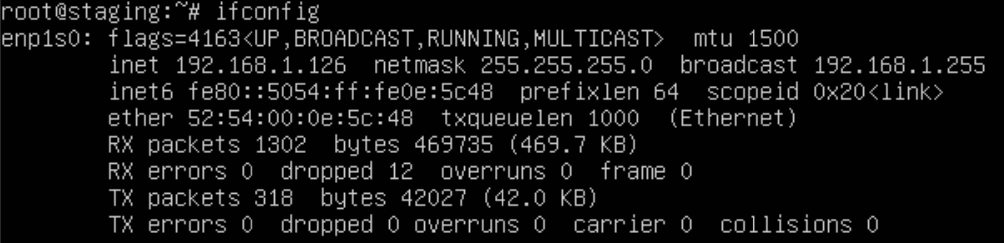

My Ubuntu Server VM was working perfectly and had its own DHCP IP on the network.
Today, I added an "Unraid Share" passthrough and the NIC disappears on boot. If I remove the share and generate a new MAC address, the NIC reappears and I get an IP on boot.
Not sure how to fix?

So just to reiterate:
- When unraid share is not passed through, networking works, enp1s0 exists and the VM receives an IP from DHCP.
- When unraid share is passed through, networking fails, enp1s0 does not exist and the VM does not receive an IP from DHCP.
I just can't figure out what the conflict is.
