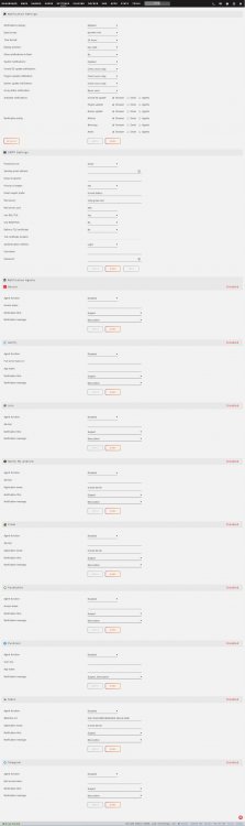

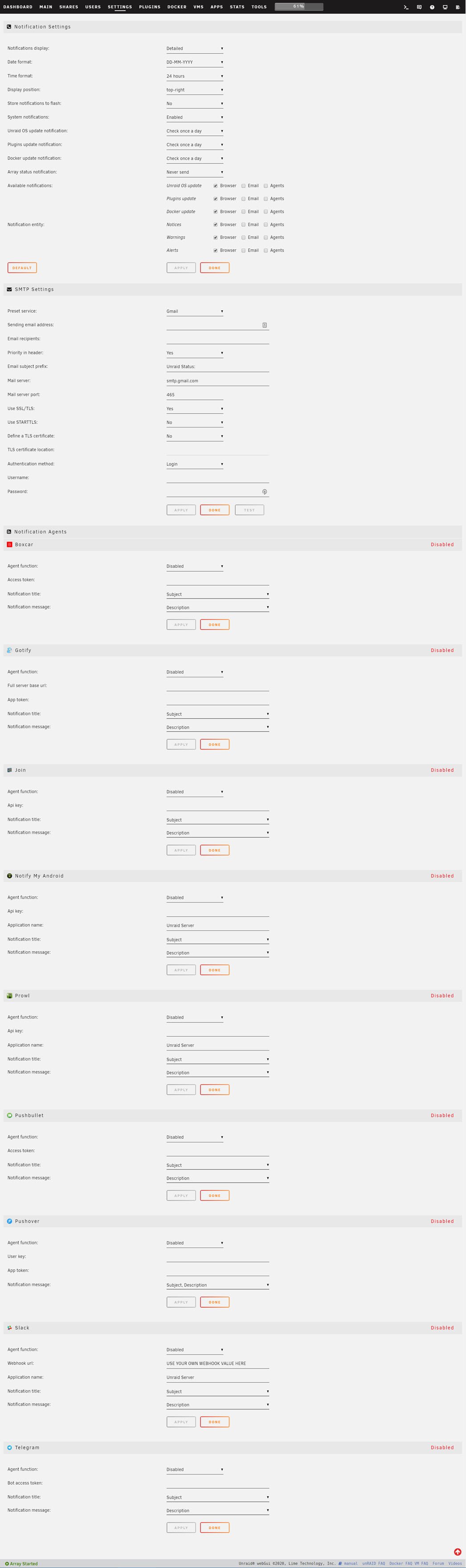

I unchecked ALL email notifications. I only like to get my notifications on the browser. Where it says SMTP settings in the notifications area it defaults to GMAIL. I look through the list and there is no selection DISABLE or anything like that. If I hit RESET, it goes right back to GMAIL.

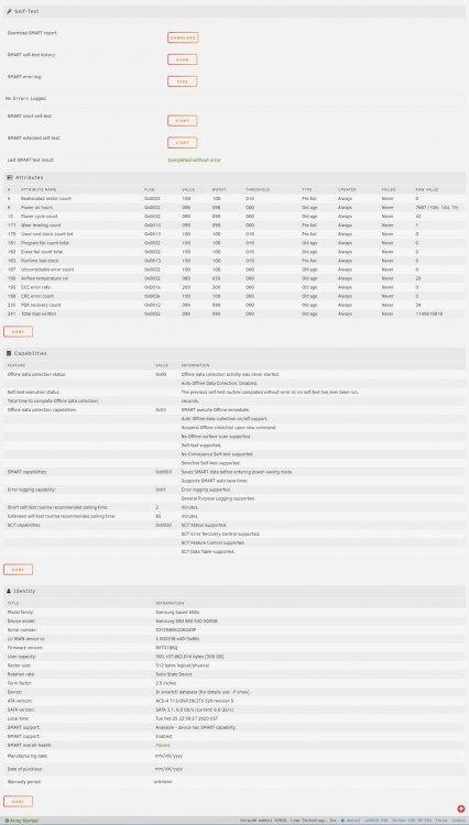

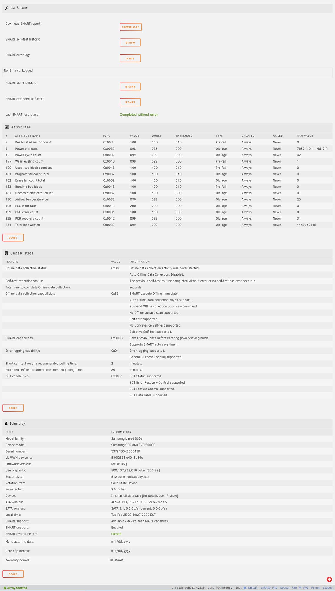

Ok, here is my whole drive page for the drive SDI. Which button would I click on to see the results?
15 hours ago, trurl said:
the button to Show the test history is right there
The SHOW button next to the text "SMART self-test history"
I clicked on all the buttons that had SHOW in it and every line and log stated
COMPLETED WITHOUT ERROR
I'm just a little confused, since I kept getting that error from my first post on this same drive. If nothing is wrong with this SSD drive, why the errors in the log? I guess that's what is confusing to me. I think I'm expecting to see errors but I do not.
This is the error I get all the time on this SDI drive that has no errors with the extended test.

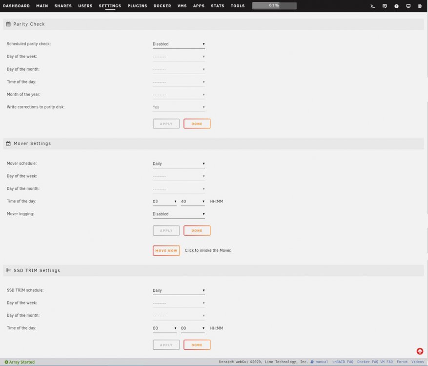

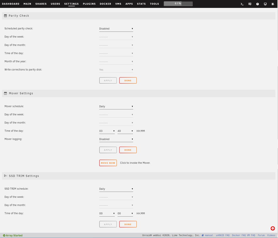

Is the SSD being trimmed at midnight? Trim won't work on that LSI and can cause those errors, which in that case are not a problem, besides the SSD not being trimmed.
TRIM was configured at defaults which was DAILY, so I disabled it since if it isn't going to work anyway. I'll do a reboot and see if those errors still come around. I know I'll still see unraid try to connect to Gmails SMTP server. Can't seem to stop that.
Ok, I just disabled TRIM and rebooted. Server been up only 15 minutes but no SDI messages yet. I'll need to wait a little bit when some notifications comes through to see if the system tries to connect to Gmails SMTP server. I have selected ALL notifications for browser and unchecked everything else, so I'm not sure how those Gmail connections are even in the log.

Now that there's more info, this is cron attempting to email because the cronjob failed (mover returned error 1)
Mover even if all shares are disabled to move always runs (but, there has to be some share that is eligible to move, otherwise it wouldn't be attempting and failing).  Either way, have you remove all email addresses in the smpt settings if you don't want to use it.
Otherwise, you need to set up gmail to accept connections from less secure clients (or whatever it's called in gmail settings)
Only shares APPDATA and DOMAINS are selected to ONLY use cache drive but right next to the setting where it says NO there is a comment, MOVER TAKES NO ACTION.
But since I changed that TRIM setting to disabled I don't think I have seen any attempts just yet. I'll come back to it in a couple hours to check.
