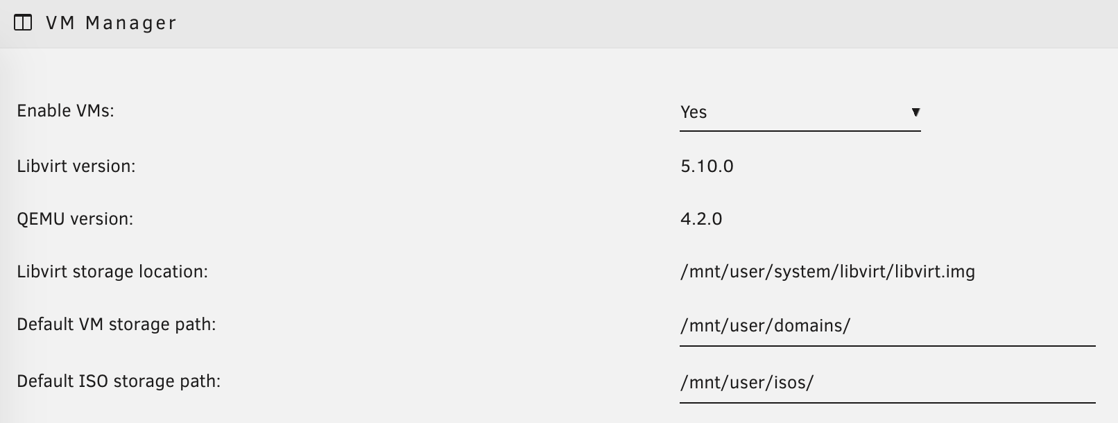

My VM setting:
1831396984_Screenshot2020-02-23at17_51_50.thumb.png.42c6c50b08b7f00400697eb19bf2a3a5.png
Now, it seems that I am not able to reproduce the above lines error, but I am still having the issue of not able to get an IP from the pfSense DHCP Server after restarting the pfSense VM, only a complete shutdown of unraid would solve it. Any advice would help thanks!!!
