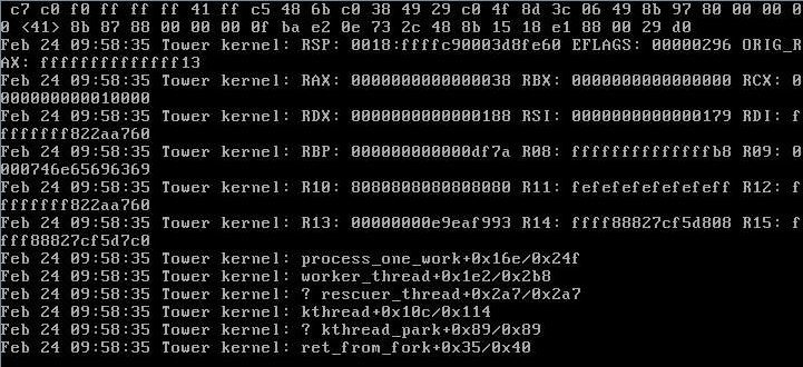

System was responding but after asking for diagnostics it appears to now have crashed. I can get to the console with IPMI and have been able to log on.  Last thing I saw on the console is attached as a JPG.

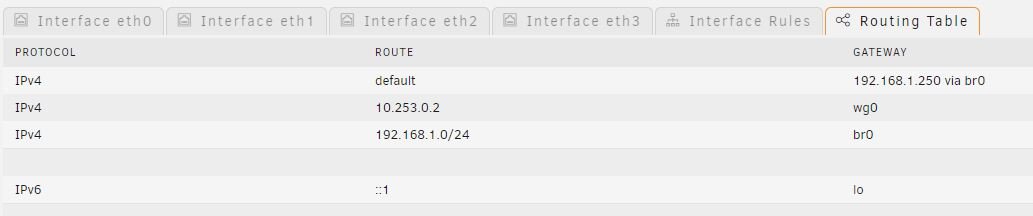

I think I need to do something with the routing table, never did that before, it now looks as follows:

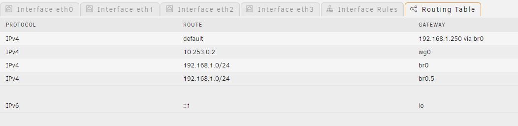

I now changed it to the following:
But this has not fixed anything... I cannot reach my dockers anymore ..
I actually changed the VLAN number to 6 since 6 is a VLAN number I also use internally.. Does not seem to do anything though..
