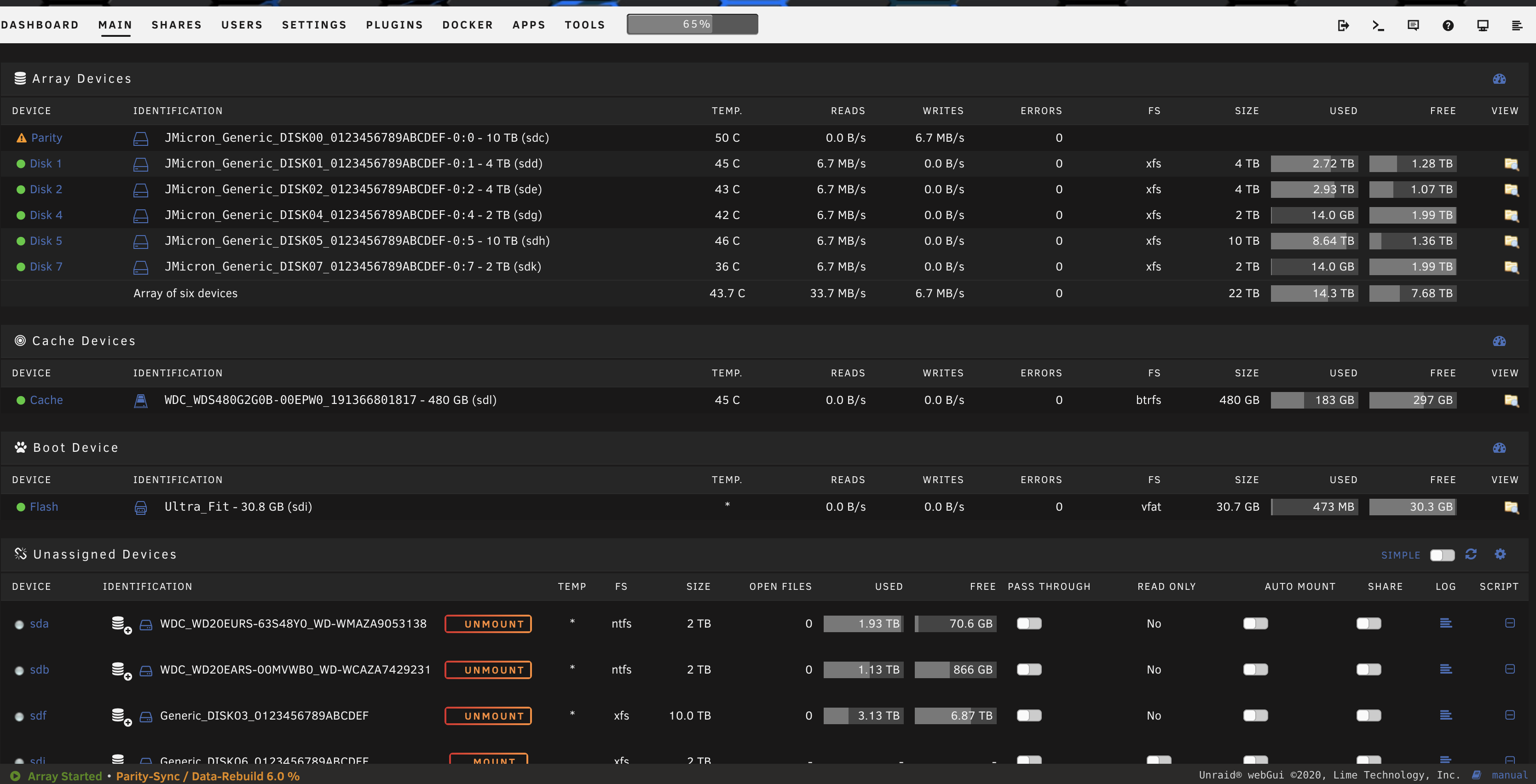

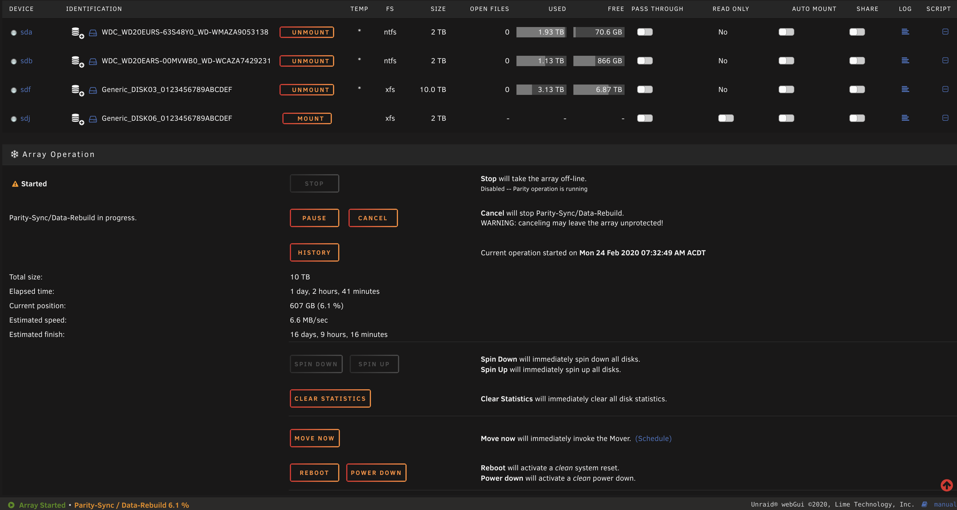

Sorry for the confusion about the rebuilds. I've tried a few different things in the last couple of weeks. Initially, just a repair of the disabled drive from parity, but that was taking days to complete and when it was almost done got knocked again (I've since sorted that out). When I tried again it estimated 44 days to rebuild, so I cancelled thinking the drive was screwed, copied the emulated data to another external drive outside the array and did a new config without that drive and another empty 2Tb drive which had increasing errors, and am now rebuilding the parity with 5 hopefully healthy data drives.
I'll attach a screenshot of my main page. The drives all seem to be independent with individual bare metal access. The total array Read Speed stays fairly constant between 30-35Mbps, but the individual disks Read Speed can change depending on how many are being used to calculate parity, i.e. if the 2Tbs aren't used, the remaining 3 drives will be 9-10Mbs and if the 4Tbs are out the 10Tb will do 30-35Mbps. The write speed on the parity will be the same as any individual drive. I don't blame you for struggling to get your head around it, since I still can't either. Is it possible something about the NUC isn't playing well with unRAID since the Acer used to work?
That suggests the USB link is the bottleneck, like it's using USB 2.0 instead of 3.0, 35MB/s is about write for USB 2.0, though correct speed is detected during initialization, at least for the USB controller, can't see the actual link speed with the USB devices, try different cable/port to see if it makes any difference.
