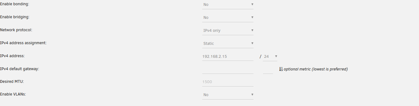

Here's what my 10Gb network setting looks like (they're all the same bar the ip addressing as above, i think i need to do some 'bridge' work but just what?
This is 'eth2' on my 192.168.1.15 machine.

last question, does the 10GB is that a direct connection, no dhcp involved?
Yup ... peer to peer. 1m cable. I need a dedicated connection for docker to "see" each machine on but no idea how to set this up.

Thanks. I'll take a look but I think it's what is needed to join both 10Gb cards together in their own 'lan' and then point the docker to use it. Sync thing only talks across the two machines but I can't set it up to use my 10Gb cards. That's my problem. There's no internet access at all.
