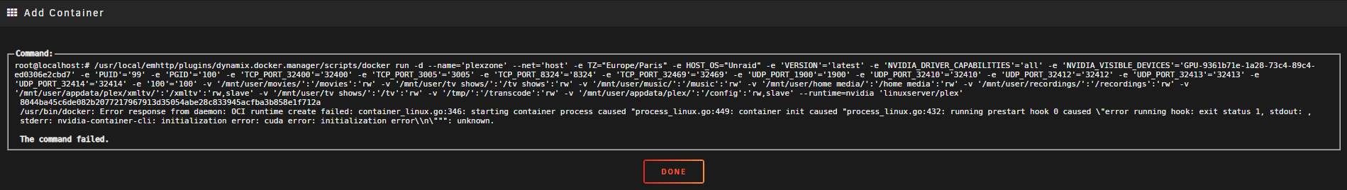

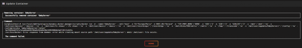

After replacing my cache with a large drive I have had problems with my dockers
I then did a rebuild - deleted my old docker-file and downloaded and reinstalled all my Dockers

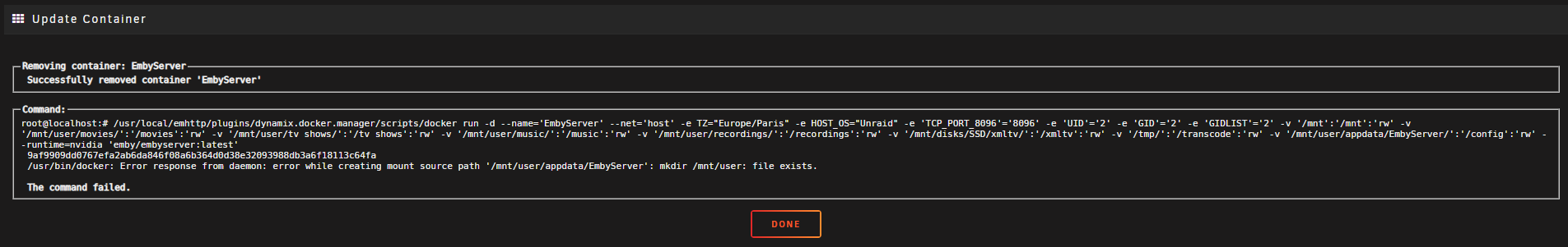

But afterwards I see strange behaviour Dockers that will not start but seem to be running (Green arrow)
Dockers that just stops? or Emby that was running perfect before just stops and give errors? (Didn't change anything)
Here is my Diagnostic files I hope someone can help me!
Your help is much appreciated this is so strange?

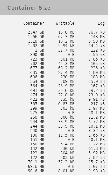

My container size is 40G no where near that:
plexzone-diagnostics-20200224-2209.zip

This really scares the shit out of me......
How can the user path be gone?
Should I reboot the system?
Seems my User shares disappeared?
Starting and stopping the array didn't help....
Rebooting and hooping that will get my user shares back....
Edited by casperse

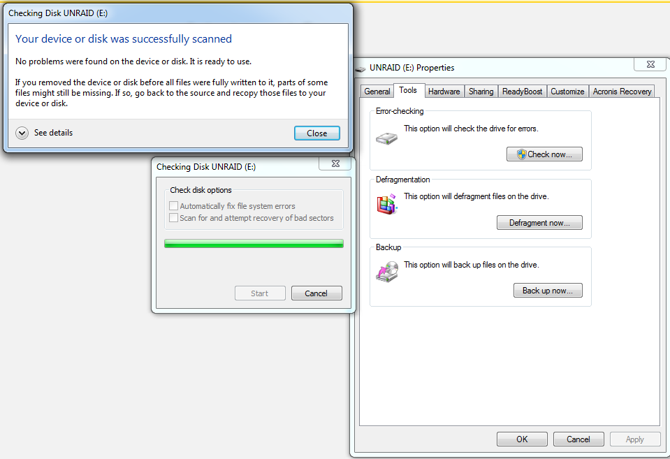

Do a disk check on your USB stick.
Stick dropping offline / corrupt can cause weird problems.

You might be right... just got this new error
I think the Nvidia files is on the flash so that would make sense!

Update: Following the error leading to the Nvidia plugin which apparently also located on the USB?
I re-installed the plugin and rebooted the server, sofar it looks like everything is running again?
Could this cause the loss of User shares? (I didn't know that the Nvidia plugin was such a big deal of the Unraid server, if this is the case?)

BTW: Just took my server apart to get the USB out and I did several disk check in windows all was fine no errors

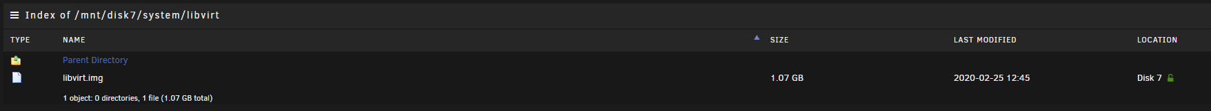

Your system share has some files on the disk7. Maybe libvirt instead of docker image though. You might just check the contents of disk7 to make sure your docker image is on cache now.
Yes I can see that this is the libvirt

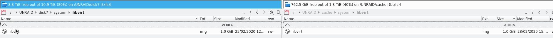

I have disabled VM and I am running mover now, shouldn't that move the file to cache? (I have system prefer cache setting)
If you disabled it in Settings - VM Manager then that should work.
If it still will not move then check that there is not already a copy on the cache drive.    Mover will not do anything if the file already exists on the target.
Yes its on both? - which one should I delete
Update I deleted the oldest file not updated on drive 7
Edited by casperse
Ups didnt like that getting a Libvirt does not start error now....
