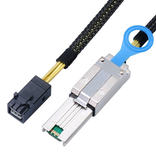

Cables like that should be very difficult to find, you could use something like this:
image.png.7c4d52e4376268203a2ccf96e0de120b.pngthen image.png.f0bfb37f7a248fbeb1ec58543d9d0a7f.png
Though total length from HBA to drives should be max 1 meter, assuming SATA drives without a SAS expander on the backplane.

SFF-8643 to SFF-8088 cable + SFF-8088 to SFF-8087 adapter

17 minutes ago, uldise said:
The problem with that is that the 8087 end is male, and I need an end that is SFF-8087 female to connect with the cables I have.
Thanks for looking for me, though.  I appreciate the help.
