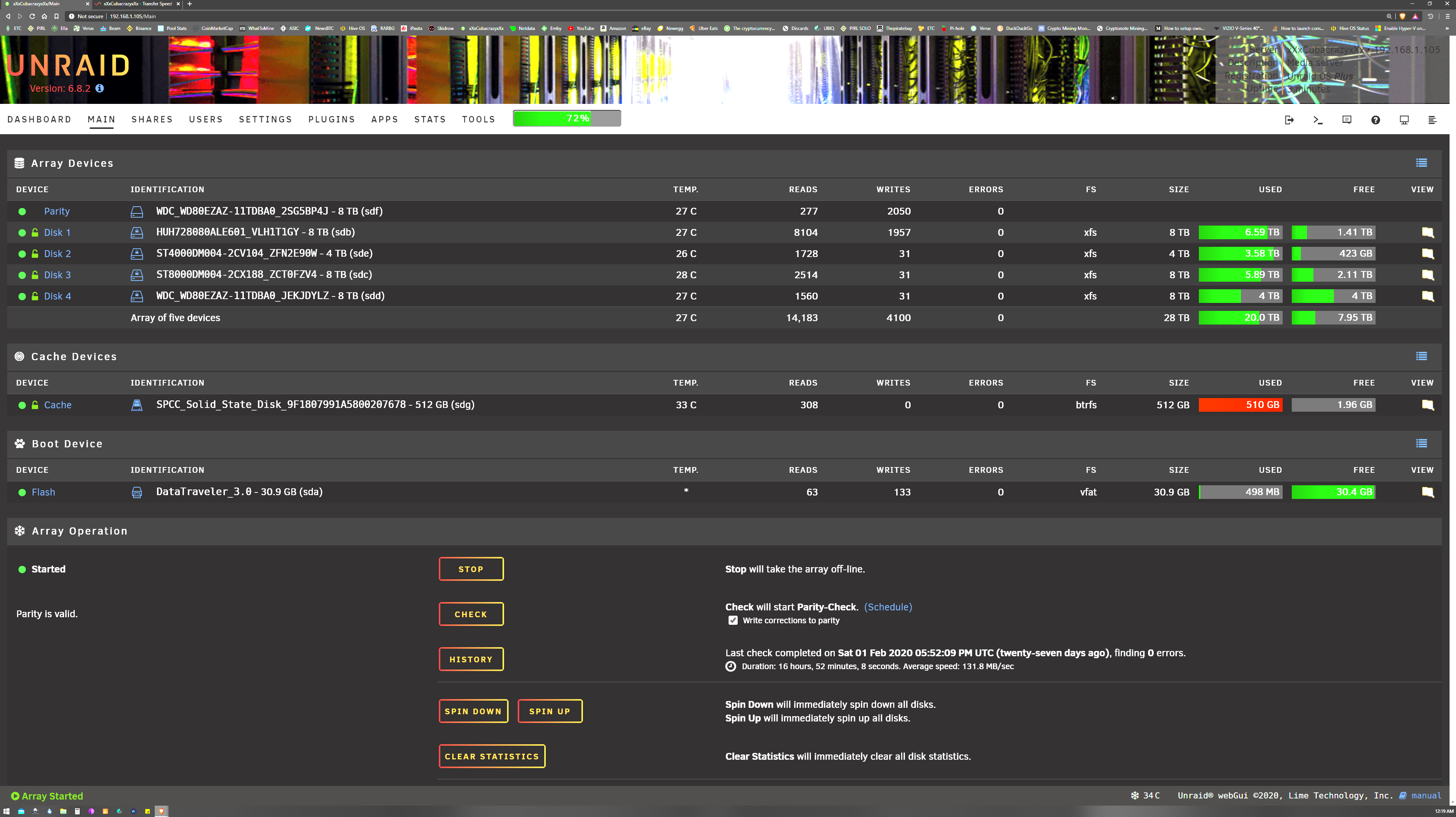

mmmm....the reason i thought that was my issue is because after 28 GB of data transfer it start acting funny when my SSD cache is nearly epty...it moves the data to the ssd but i think that something is tie to the ram causing that issue

You have set all of your shares to cache-prefer. Prefer means write to cache and never move them to the array. Normally only appdata, domains, and system shares should use the prefer setting, at least until you understand why you would do something different. All other shares that you want to use cache should be cache-yes so the files will be later moved to the parity protected array.
And appdata, domains, and system shares are not all on cache even though you have them cache prefer. Probably you enabled dockers and VMs before you added cache, so those got created on the array. You need them to be on cache so your dockers and VMs will not be impacted by the slower parity writes, and so your dockers and VMs will not keep array disks spinning.
Also, Mover can't move open files, so it won't be able to move appdata, domains, and system to cache where they belong unless you disable the Docker and VM services.
  1. Set all shares except appdata, domains, and system to cache-yes
  2. Go to Settings - Docker and disable the Docker service
  3. Go to Settings - VM Manager and disable the VM service
  4. Leave Dockers and VMs disabled until told to enable them again
  5. Go to Main - Array Operations and Move Now
  6. Wait for Mover to complete
  7. Post new Diagnostics

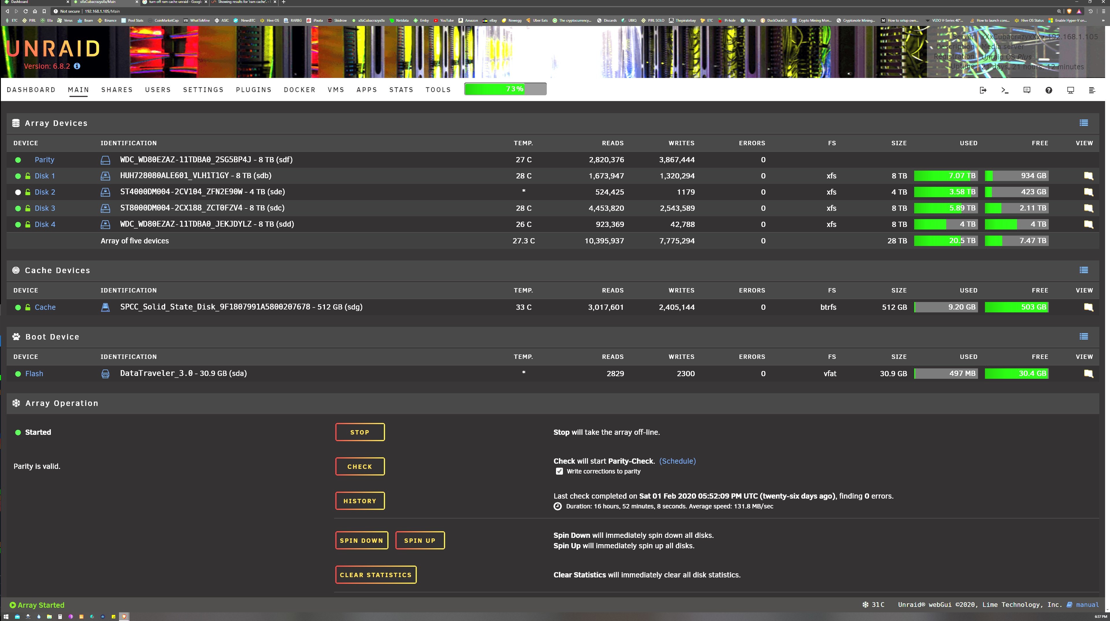

Ohhh man!!!!!! it moved as long is it could to the cache...i disable docker and vms and im moving it back now..last time it did that it ruined one of my movies finguers crossed it will move everything back safely
That looks good.
