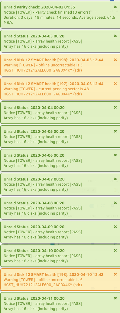

2. Drive Errors
Parity reconstruction took about three days and finished without any warnings. Then I started a parity check requiring another three days, it reported zero errors. Only 35 hours later however I got notifications for "offline uncorrectable" and "current pending sector" (see screenshot) from a data drive not physically touched during the parity upgrade. Seven days later there is yet another warning. During all this time, I left the array in maintenance mode because I wanted to observe how the situation evolves before writing to it again. Then I downloaded the S.M.A.R.T info for the drive (tower-smart-20200412-2324-1.zip) ,  started an extended test and did the same again (tower-smart-20200412-2324-2.zip). The extended test came back immediately, while I expected it to take some time. After that, I immediately shut the server down, alas without doing diagnostics first.

  • I did not find any definitive answer, what "Current pending sector count" and "Offline scan uncorrectable count" precisely mean. Google hits resulted in conflicting answers and the documentation from the T13 Technical Committee just says "Number of unstable sectors (waiting for remapping)" for the former, "Number of uncorrected errors" for the latter. There are 48 pending and 6 uncorrectable sectors, but no reallocated ones, which I don't fully understand. So it's not clear to me, whether the pending sectors already signify data loss, but the uncorrected errors definitively do (assuming they contained data, of course). Agree?
  • I assume, that I can no longer trust this drive and have to restore data from parity. Agree?

Pending sectors usually mean bad sectors, i.e. sectors that can't be read, extended SMART test confirms it's a disk problem, so yes you need to replace it.

In that case go ahead and replace the failing disk.
