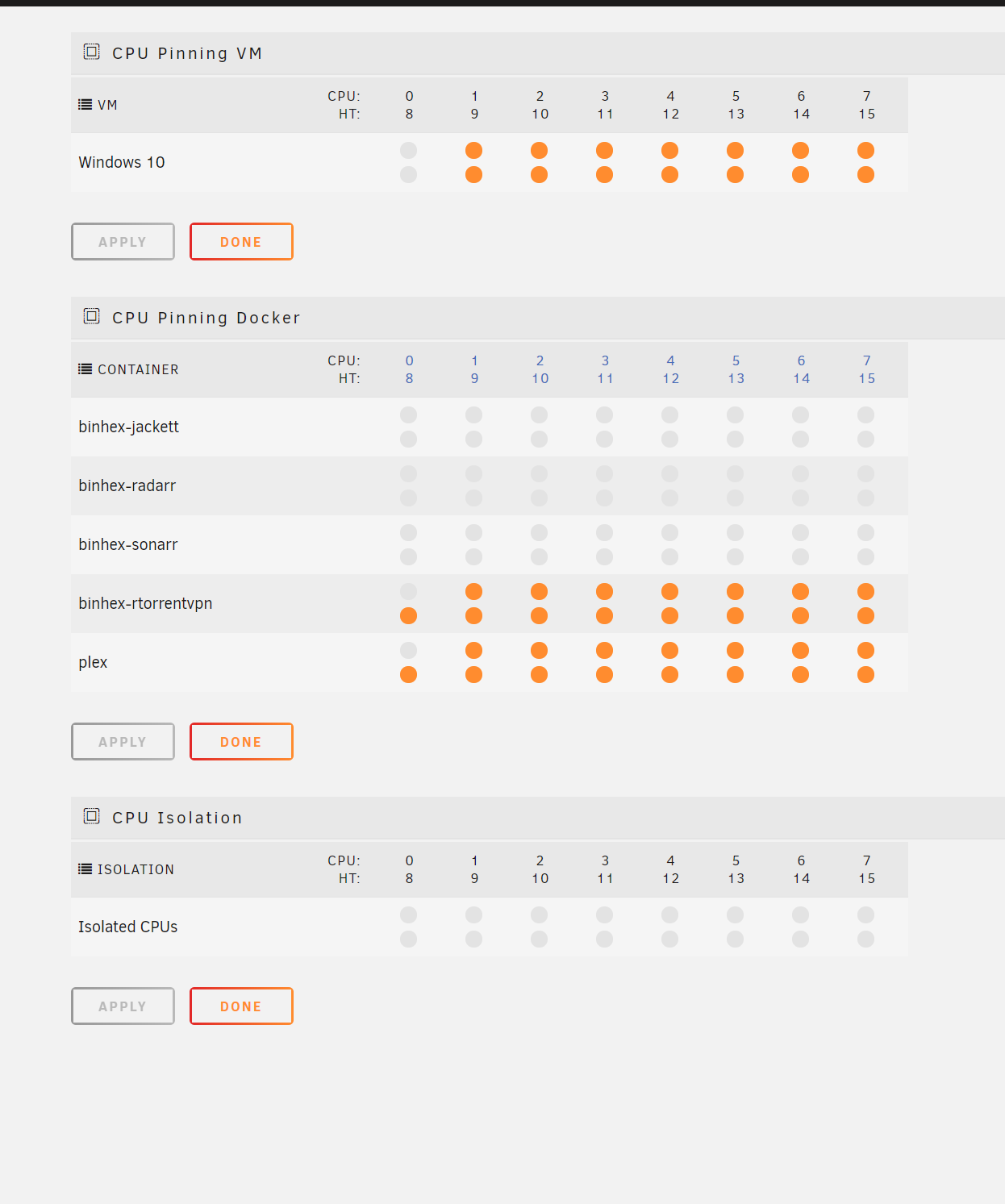

Let me explain.
I have windows installed in NVMe and that NVMe is passthrough to my windows vm along with SDC.
As for the Plex, its a docker.
Here is the config - https://prnt.sc/ravre4
Can you attach the screenshot to the forum post instead of using link please.
There!
How is your NVMe passed through to the VM? via PCIe method or via the sdx method?
If you are using the sdx method for the NVMe, have you even attempted the PCIe method?
As I mentioned previously, anything other than the PCIe method will to some extent lag under heavy host IO.
In addition, your CPU core assignment is not the way to do it.
  • By sharing core between torrent + plex + VM, what do you expect to happen when 1 of the 3 is hammering the CPU?
  • Core 8 and 0 are a pair. They both should not be used by Plex and torrent.
  • For best VM performance, you want to set up CPU isolation to isolate the VM cores for VM use only.
You probably need to watch more SpaceInvader One videos on Youtube.
