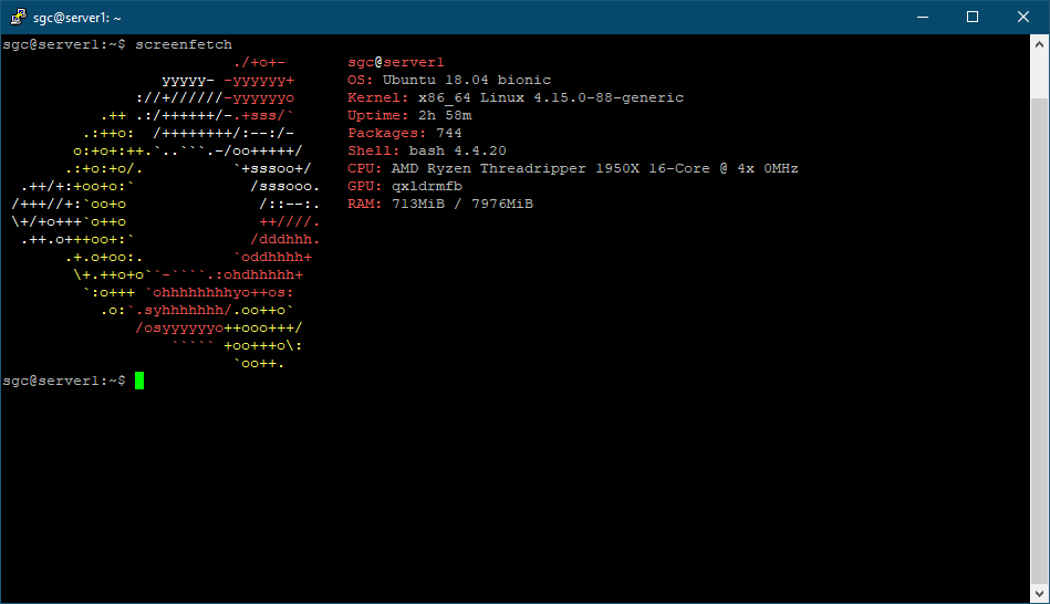

I started using UnRAID a few days ago, and I ported one of my VMs into it, that was pretty straight forward and easy to do.
The problem is, most of the times when it boots, when I do a "screenfetch" command to get the GuestOS "specs", the CPU Clock comes as 0Mhz.
Has this happened to anyone?
The VM is running Ubuntu 18.04 Bionic (Server)
The problem I have is that some programs I run, mostly Source Dedicated Server and SteamCMD, require the clock frequency of the server in order to function properly.
Some other programs I run also require it, and without it, stuff stops working.
I hope someone can help me with this,
Thanks in advance,
- AltairPT
Unraid uses open source KVM as its virtual machine engine, so googling kvm guest reported cpu frequency may give some answers. As a start, maybe try changing from CPU pass through to emulated?
