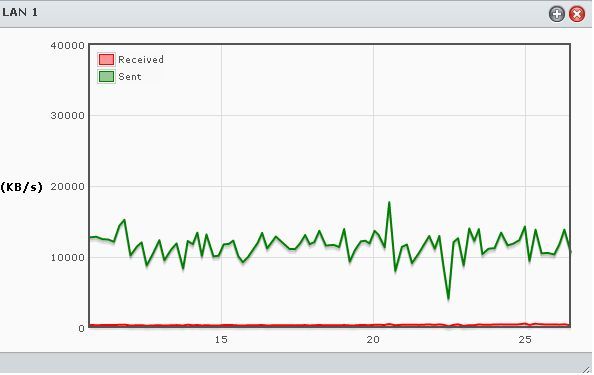

Well...I started with as expected file transfers (25-35MB/s), no issues.  Over the week-end, I noticed that transfers were taking longer.  I found that the transfers maxed out at 100mbps (~12MB/s).  This would indicate that it was not a 1000mbps connection.

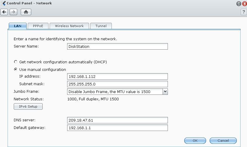

Eth0 shows 1000mbps, no issues found in the syslog, client server indicates 1000mbps connection...I'm stumped.
My connection is from the unRAID to a D-Link DGS-2205 to the Synology DS-210j.  The files are transferring via NFS (mounted on the Syno).

Well..I found that one of my drives (7K1000) is known to have slow writes.  Other drives in the array (5400 and 7200) range between 20MB/s - 40MB/s.  The Hitachi (7200rpm) 7K1000 will reach peaks of ~20MB/s, but averages ~12-15MB/s.  Strange that it is that slow.

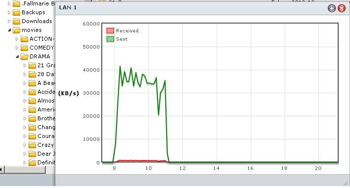

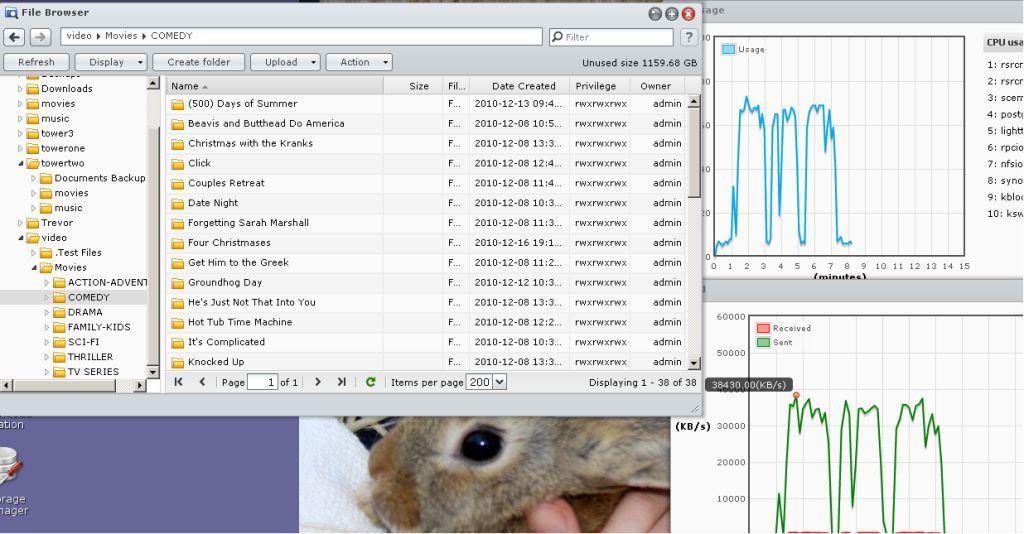

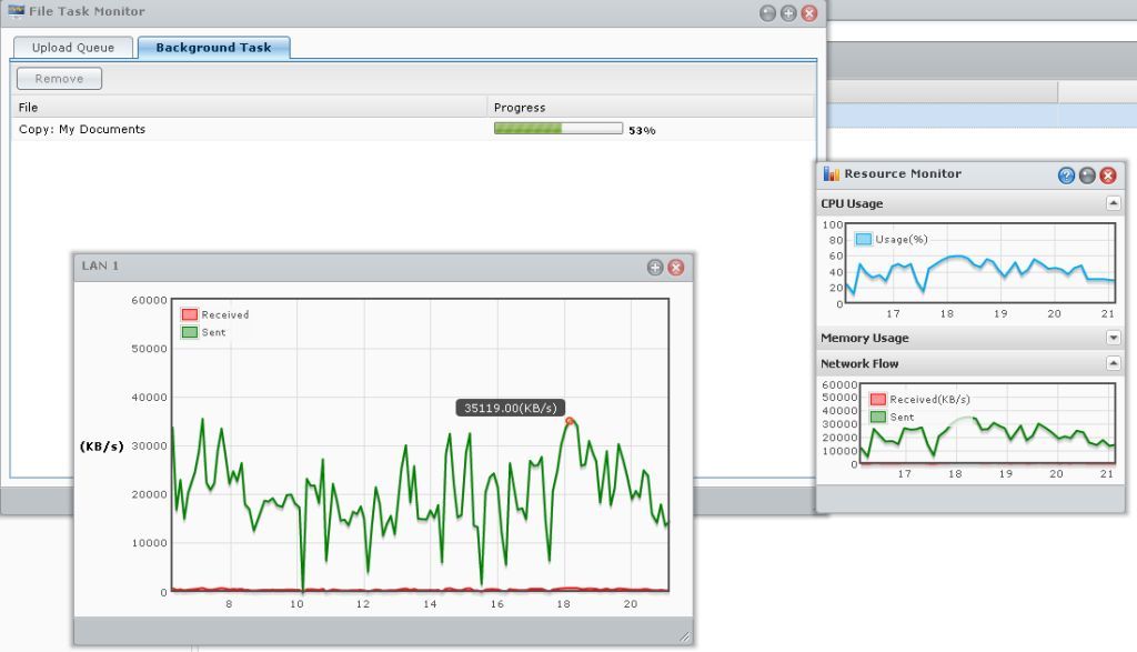

Just for a conclusion, and maybe a search for something better in the ethernet switch department?, I tested copies and moves of the same file to each of my disk shares).  Each performed equally ~35MB/s (see attached), and were faster than writes to the Syno :)
