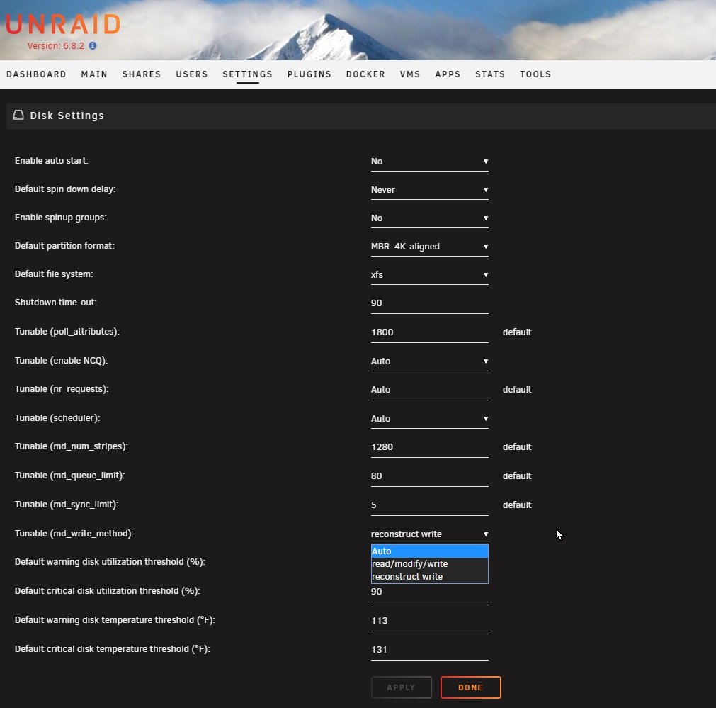

Issue:
I'm constantly having slow write performance transfering over a 10G link from a Windows system that can saturate a 10G link (9 drive Raid6).  1 issue that I'm going to shelf is that max speeds for the 10G link seem to only peek at 3G.  Outside of that I saturate the 3G for about 30 seconds of starting the transfer and then it drop to 30-70Mb/s average write.  It is consistent.  Files being transfered are very large moves, so 2-30GB single files.  When it starts to write a new file to another drive in the share it will spike up again for 30 seconds (3GB/s) and then drop back to the 30-70MB/s speeds.  If I pause the transfer and let the parity stop read/writes and resume it will spike 3GB/s again.  On the MAIN page the Parity drives are showing READ and Writes that are sequential and generally both drives are very similar in numbers.  When the system spikes in write speed (network transfer speed)  the reads go down to KB/s.  (so it Reconstrust really working?).  On average I see both Parity drives displaying 52MB/s Read and 52MB/s Write (for both Parity drives).
From a READ perspective I've tried:
letting all transfer stop working.  Copying a file from UNRAID to a remote system.  I can easily max out a 1G link the entire transfer.  Between the 2 machines on 10G link I can get approximately what the single drive is capable of transferring at (180MB/s) SOLID.
System:
  • 10G links on both ends - Flow Control is disabled.
  • 2 Parity drives in Unraid - Reconstruct Write is enabled
  • Not using Cache drive or SSDs (writing directly to the HDDs)
  • Drives are all ST10000VN0004's  - 10TB Seagate IronWolf drives. (2 cache,  6 data)
  • Share settings: Most Free,  Split top 2 directories (essentially putting the movies on all 6 drives based upon space available of each drive)
  • All drives are connected at SATA 6GB/s
  • Not sure if it was relevant but I did do SMB Local Master - Didn't make a difference
Solutions:
  • I already have 14TB of Parity information written removing the parity drives could speed up my transfers?  But then it would have to re-write ALL the data to the drives again.  This seems like a band-aid to the real issue..
  • I have 64GB of system RAM why cant some of that be used to cache?  If it is why so little?
  • I could enable my SSD cache drives for this but they are only 1TB drives (raid 1).  I'm trying to transfer over 20TB of data... Not going to work with this design, Plus I would still have to run mover and then encounter the same issue again.
Thanks in Advanced for the support.
And yes I did search the forums and read many articles and many are not resolved, some did but were not related, etc.

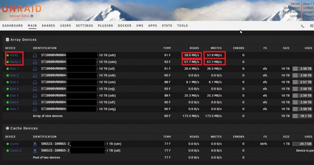

Totally get your point here.  Looking back at architecting this Unraid server there are many things I'm massively disappointed with but at the same time I do like it.  So its really a toss up.  With FreeNas I could saturate a 10G link EZ 1GB/s np.  This is honest MASSIVELY painful for me to transfer over this much data.  Something that should have taken me a weekend to do has taken me 4+ weekends.
I would have figured the parity would not need to read as much data as it is writing during a write operation, this seems really inefficient.  There has to be a better way to use cache to alleviate the read process of the drive.   Unraid displays that the drives are reading and writing sequentially around 50-60MB/s.  If the reads were removed I could easily max out the drives write speed getting me at least over 100MB/s.
When writing to the array then the cache drive is not involved.
Have you read the description of Unraid write modes to understand how Unraid handles array writes?   If you want to eliminate the reads from the parity drive then the Turbo write mode achieves this.

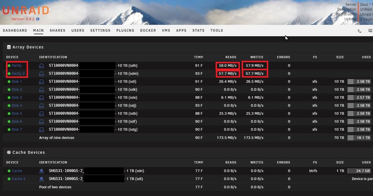

The red section DEFINITELY does not look like you have turned on reconstruct write (aka Turbo Write) correctly.
I would recommend you check the settings again.
During write with reconstruct write, there should be zero read on the parity (only write).
I'm not sure what the problem is then, especially if you set it to reconstruct write and hit apply under disk settings. I just tested what my server's behavior is during a large write. It writes the file to one drive, then reads the rest to build the parity. The drive being written to does not have much in the way of reads occurring. How are the disks connected?  Are the disks directly connected to the motherboard sata ports, or do you have an HBA present?
To be honest, with you seeing high reads and writes simultaneously, I would try to set reconstruct write again. Like I said, for me, the disk being written to writes at line speed and has minimal read activity. If I fire up two transfers, then I start to see both high read and high writes on my drives.
Also, and I don't believe it has to do with your problem, but I would install the tips and tweaks plugin from the apps and set your CPU scaling governor to performance. I was having some stuttering and other issues because the cpu speed was not ramping up and was stuck at 800mhz. When I set it to performance, it ramped up as needed. Conservative works as well.

Then Turbo mode is NOT working.
Thats great news... but the setting is enabled... I've even stopped and started the array afterwards...
Maybe I'll set it to rwr.  and set it back... idk
Edited by pish180

yeah, something is wrong here.  Reconstruct write is not working...
I have switched it RW -> RMW -> RW
Stopped Array -> started -> Rebooted.  Nothing is stopping it from reading while doing parity.
Edited by pish180

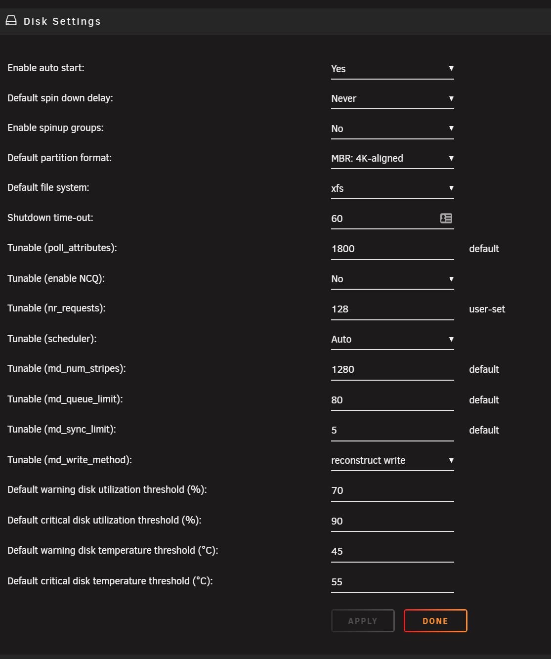

Your settings look different to mine, not sure if relevant.  NCQ should be left off by default.  I'm sure i've read this before.
Edited by sdamaged

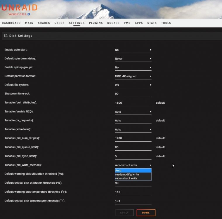

Read Screenshot
Edited by pish180
Wrong Image uploaded
What happens if you change your Share setting to high water? I suspect that parity is being reconstructed, but it hasn't has a chance to do so because you keep changing which disk is being written to. As in it's still reading to generate parity from the last movie you transferred, when the next movie is being transferred to a new disk. If you minimize the number of disks you are writing to at a time, you shouldn't see the parity being written until the transfer moves to the next drive.
I use high water because I am able to leave more of my disks spun down when watching movies etc. You have 2 parity drives, so for you to lose data you would need to have 3 drives fail.
edit: I would stop the transfer, then change the share setting.

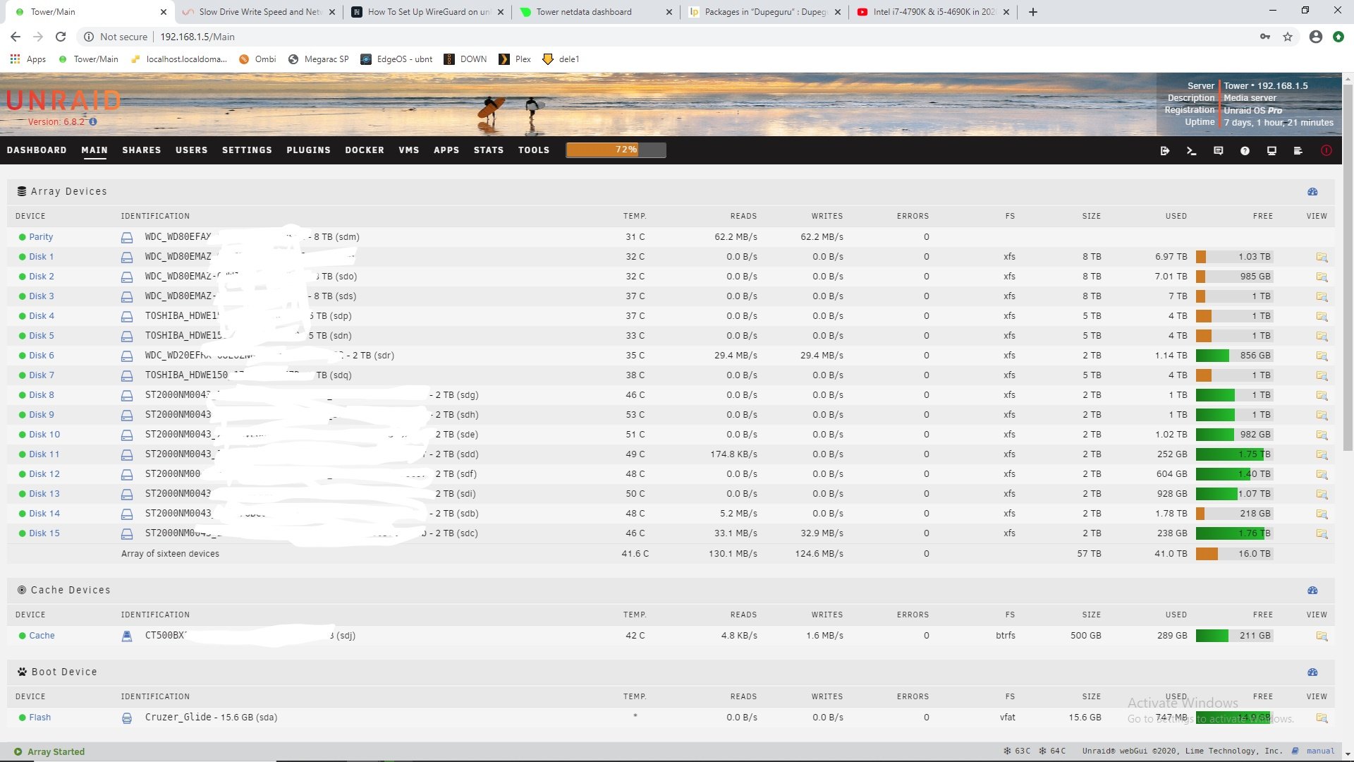

Are you basing the speeds off of what the main page says? As you can see, when I started transfers to two different disks, my parity speed looks similar to yours. My actual transfer speed did not change from ~1GB/s. I am not sure if the listed speed is the speed at which it is updating parity, or if the main page is just unreliable for reported disk speed. I can 100% say that the windows transfer speed window never dipped from 112MB/s.
To show this, I again did the transfer, watched my main page list the speed as around ~55MB/s, then took a screenshot of iotop showing the actual speed.
Edited by david11129

Umm.... WTH...
So I put it on High Water and I get significantly different results! It was able to transfer a 16GB video and rocked steady at around 200MB/s peaking at 400-500MB/s.  Once it changed to another video in the transfer queue it dropped down to 36MB/s and didn't return back to full speed.  WTF is going on here?!
