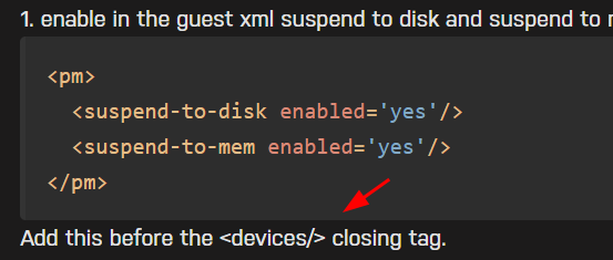

Did you enable sustend to disk in the xml?
Check this, might help:
https://forums.unraid.net/topic/130134-switching-from-gpu-passthrough-local-to-vnc-in-linux-pop/?do=findComment&comment=1184943

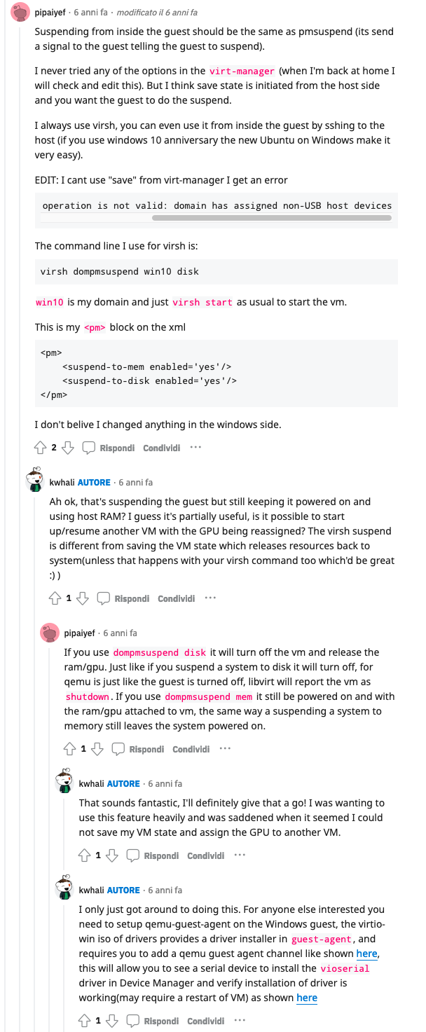

But several users reported it working with virsh commands; dompmsuspend and dompmwakeup are virsh commands to be given from the host and the guest requires the guest agent installed.
here are posts where I get some info:
https://www.reddit.com/r/VFIO/comments/568mmt/saving_vm_state_with_gpu_passthrough/

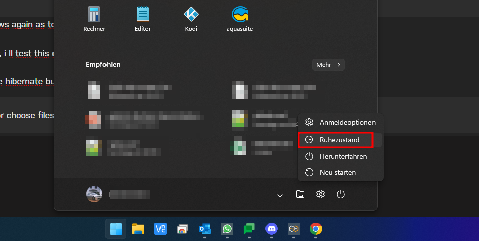

so, i enabled hibernate in windows again as test scenario
and i can say, looking fine so far, i ll test this over some period of time and see if that keeps stable
may as note, after activating the hibernate button in windows again, also working when triggered from inside the VM
will result in a "shutdown" for qemu so its running as it should be, virsh start also just wakes the VM up with all open apps ;)
very nice, thanks agin @ghost82 and @Darkman13, i dropped ths already completely as my experience was really bad with this ;)

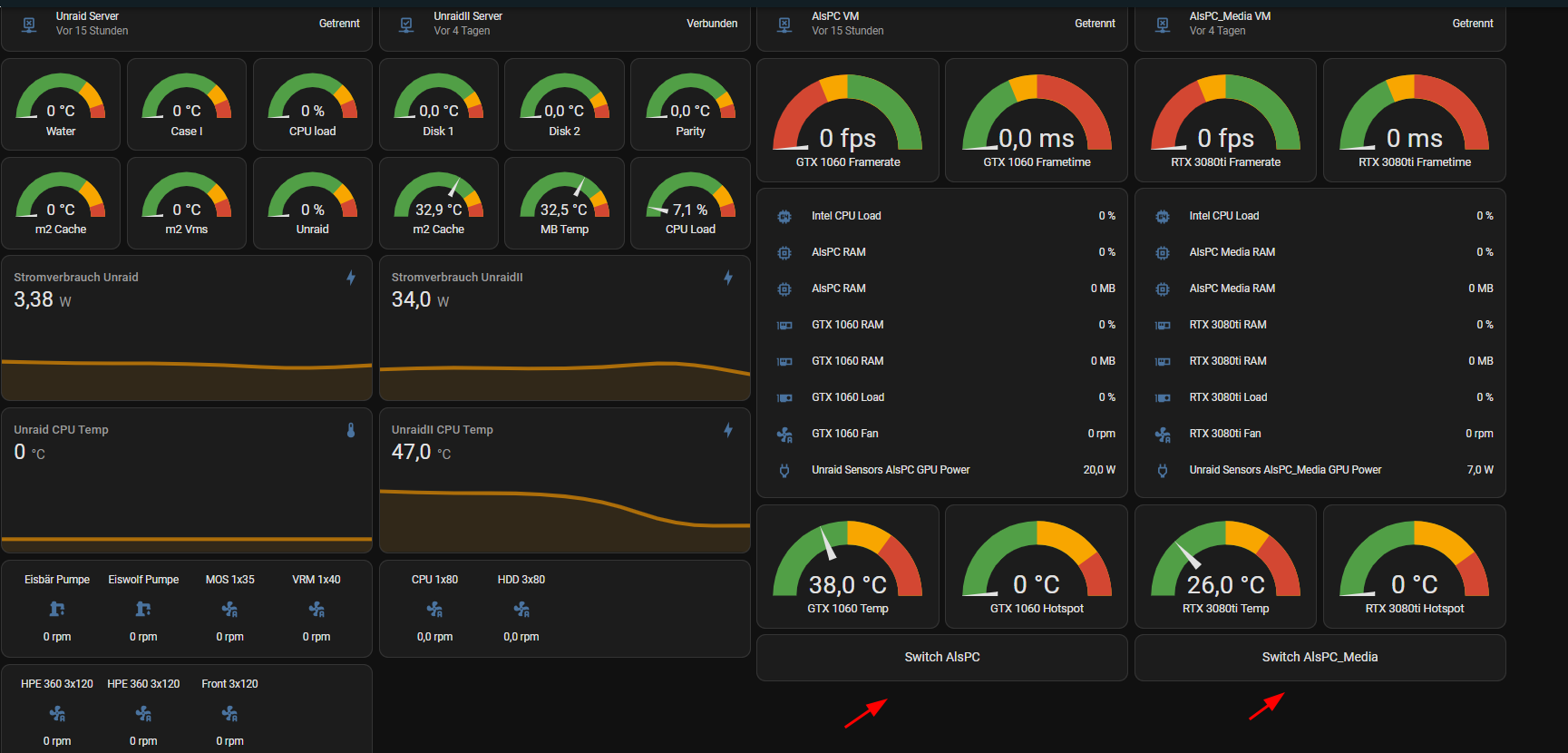

Hey i have got the solution for you i able to create a nice script with webhook to switch between vm easily
thanks, but i have 1 already here for some time ... ;) simple but working, just to "cacle" between VM's sharing the same GPU passthrough
as userscript, run in background ... will turn the running VM off, will turn the other VM on (cycle)

and actually, i even switched and use HA instead (incl. Google Assistant) to start, stop Server, VM's, ...
sample switched, short, turn on, long, turn off
