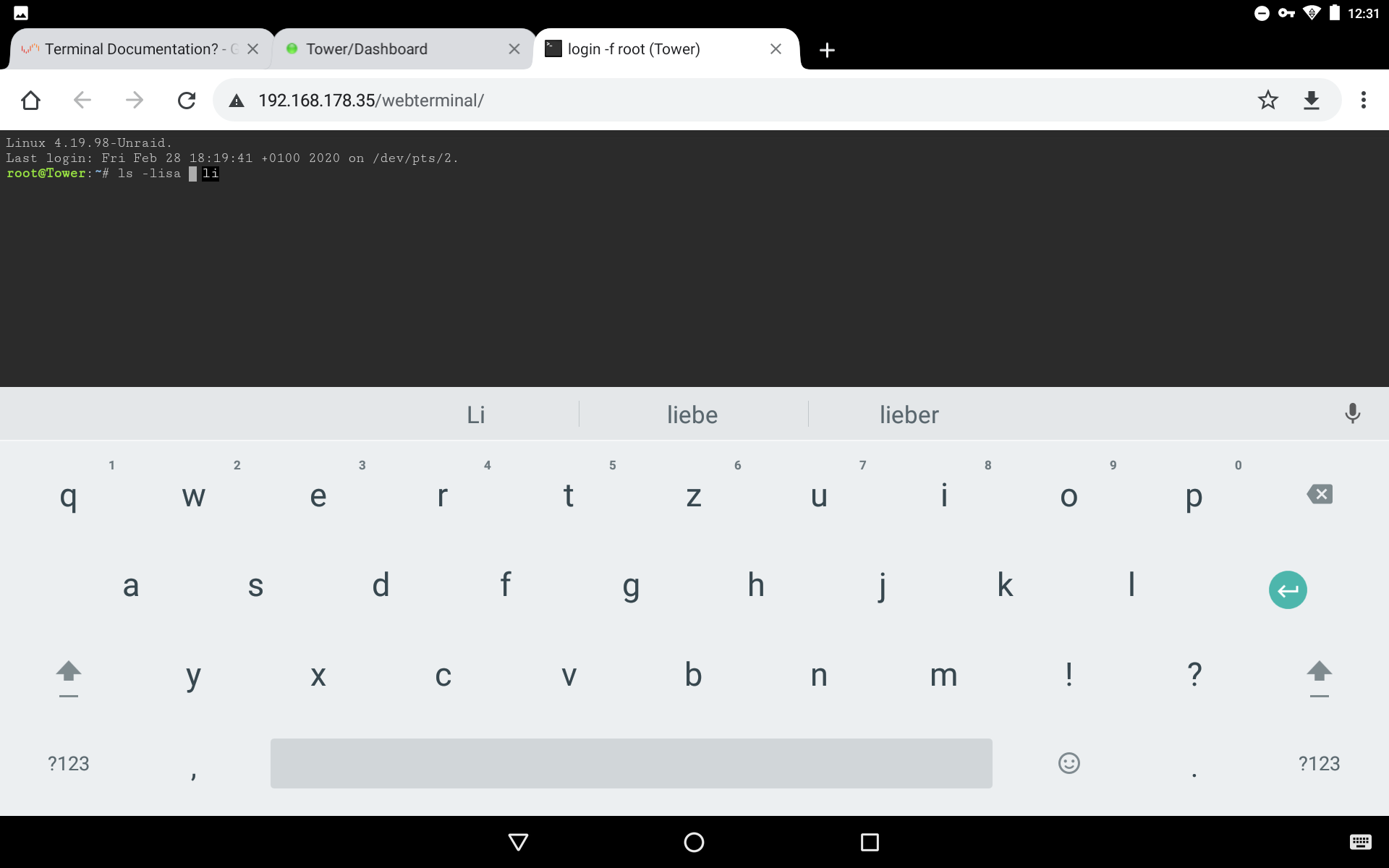

Please have a look at the Screenshot. I did enter "ls -lisa" - nothing else. On the second Screenshot I did enter two Backspace and ended up with that.

I  am afraid I do not have an Android system to check this on :(   The closest I have is an iPad ant there funning the chrome browser seems to work fine.   I can see your problem in the screenshots and that is not the behaviour I see. on my iPad.  Hopefully someone with access to an android tablet will be by shortly and be able to comment.

Just tested this on Android.
It's not special characters, it seems to be accessing type history or a rather annoying autofill.
Keep pressing back space to remove the 'suggestions'
