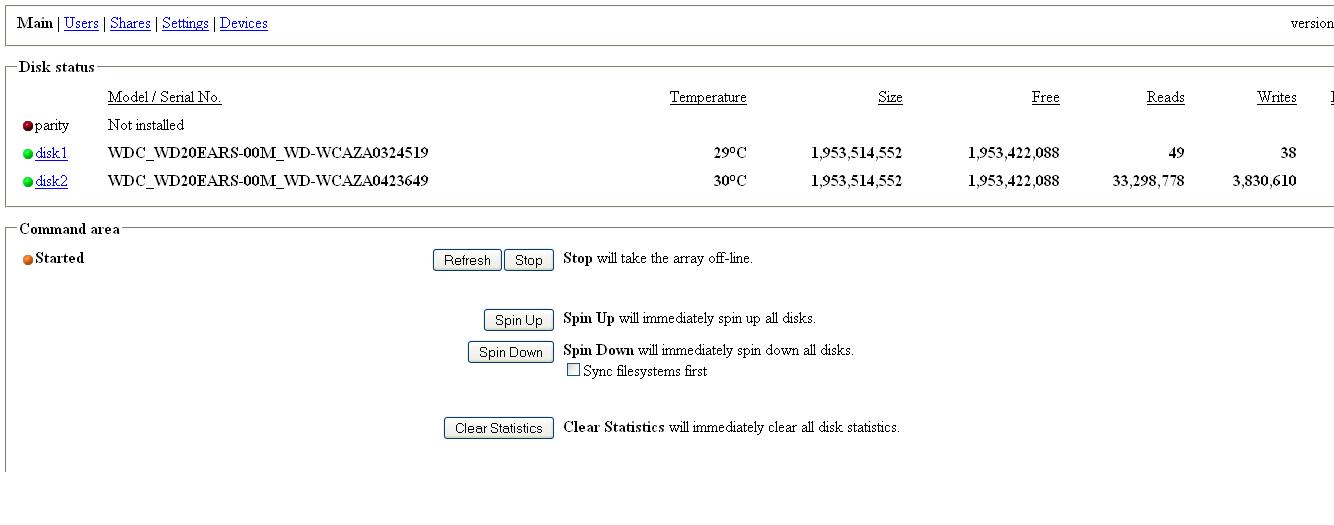

Also, when I formatted Disk1 and added it to the pool it only showed 49 reads and 38 writes, but disk 2 shows 33,298,778 reads and 3,830,610. Both show zero errors. Why such a big difference before even copying data over? I'm thinking disk 1 didn't format properly. However, I was able to transfer a movie file (through shares in my network places) onto disk1 (the slow drive), that took about 2.5 hours for 8GB. I also transfer the same file to disk2 and that only took about a hour. Do I need the bwm-ng package to determine the actual disk performance for reading and writing data? Should I just change my sata cable and run preclear again and depending on the results switch Hot-Swap Bays? I don't have the full syslogs from my Disk 1 preclears because I only copied the SMART data and even screwed that up on the first preclear. The SMART data from both drives showed that they were fine.

I have attached a picture of web gui showing reads and write prior to any data transfer, a HD_Parm for disk 1 prior to data transfer, SMART data from the 2nd preclear of disk 1, and my syslog which should include the second pre-clear of disk two all the way through transferring the files.

queeg, thanks for the info. I'm just curious why the time would go from 36 to 44-45 hours with no activity on the server, except the preclear. Especially when compared with the other EARS disk. Also, it seems weird that disk 1 didn't really show any read writes after formatting, but disk2 did. Could this be due to less errors(within acceptable ranges, and no reallocated or pending sectors) reported on disk1?
