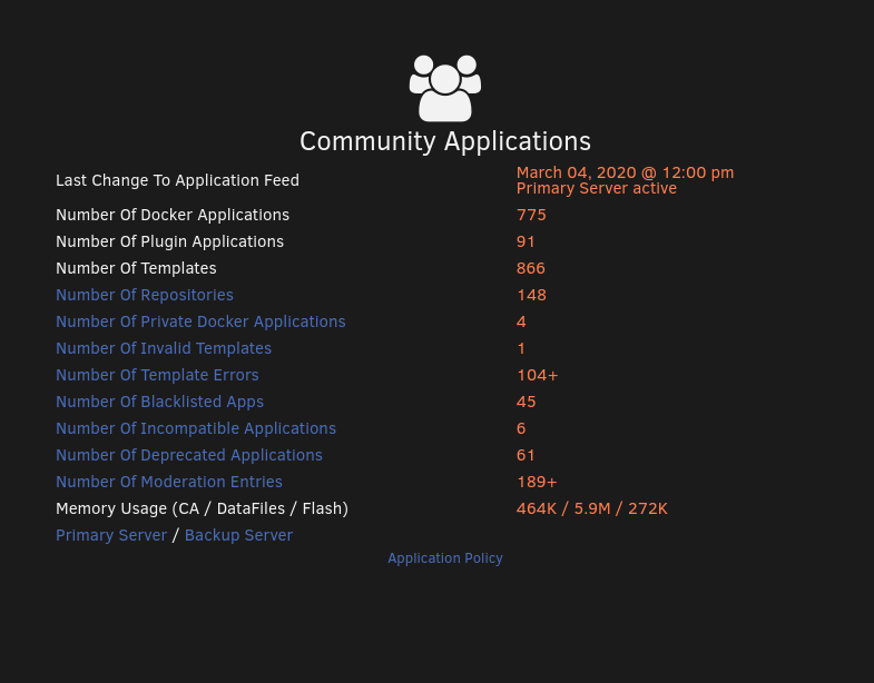

What happens if you go to the Apps Tab?  If it loads no problems, can you post a screen shot of what appears when you go to "Statistics" within it.
Apps works no problems - screen shot attached for Statistics.
@Squid - Any ideas on how to resolve this?  Thanks.
If you reload the apps page and the date hasn't changed, then it's definitely not communicating with the outside world.  (A reboot would then have Apps actually return errors)
But, I don't know what the problem actually is.  Just that its something network related on your end.  Whether that's the router / modem configuration or something else I can't really say (I didn't see anything obvious in your previous diagnostics)
