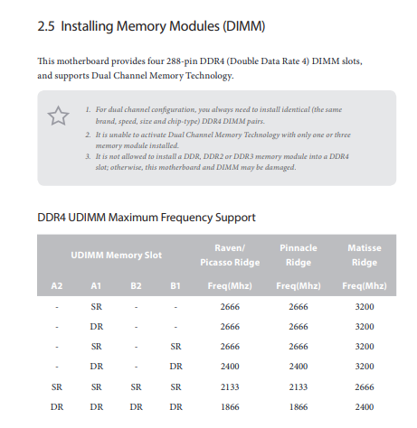

2 hours ago, christopher2007 said:
I compared the `ASRock Rack X470D4U` and the `ASRock X570 Pro4`. Both seem to support ECC, but only the X570 supports DDR4-3200. And that is recommended for the Ryzen 7 3700X
According to the X470D4U manual it does support DDR4 3200 RAM modules if you are using only two memory slots.  Matisse Ridge is Ryzen 3rd generation.  In most unRAID uses, you will not see much difference at all (if any) between 3200 and 2666 Mhz RAM speeds.  By the way, you should NEVER overclock your RAM in a server.  That's asking for instability.
You are tying yourself up in knots and overthinking many things. Figure out what you really want/need you server to do and pick what appears to give you most of what you need.
I don't have any experience with Ryzen systems and I just upgraded my system to the latest Xeon  CPU, but either one (or even an i5 to a lesser degree) will work well for you based on your list of wants and needs in your first post.
Ok, so I should let the RAM on 2666. Thanks for the warning.
