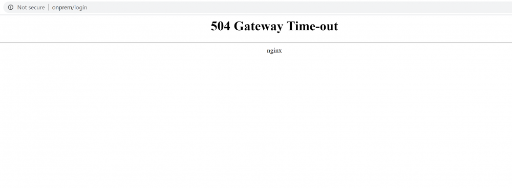

Eventually the web viewer stops loading completely and I'm just greeted with this:
Has anyone seen this?  This is new behavior for me since 6.8.
